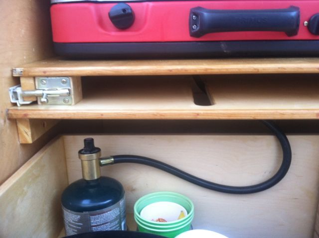

I went with a Primus stove since it uses a rubber hose that comes out the back (or the bottom). I'm not trying to sell you a new stove, just giving you something to toy with.
The one-pound bottle goes in the drawer below the stove.
T

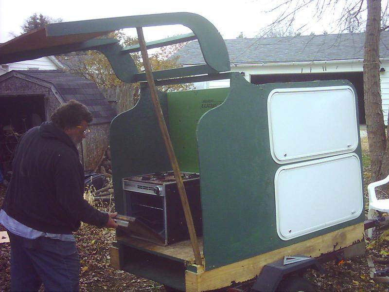

I gave the damn thing away and started this...........Image

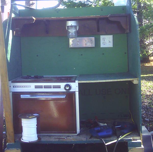

The reason I bring it up is that I have been GIVEN two of these.......Image
Had a buddy clean out an old popup and handed me all the inside goodies ( all he wanted was the frame)
This was in there Image
I added a very small lp tank and a regulator and some plumbing Image
and I have a rolling kitchen no heavy lifting just hook up and go.
The only reason I bring this up is there are unloved and unused tiny trailers everywhere. I just walk up and ask if there is a stove or two way fridge or what ever and if the trailer is for sale cheap. After talking a few minutes the guy that gave me the little harvest gold stove gave me harvest right to any thing I wanted absolutely free. He was gonna burn the trailer down. I hooked him up with a buyer a couple days later and he was $125.00 happier.
The brown one was headed to the scrap steel yard and a co-worker asked me first if I wanted it.
So take a moment and look around the back alleys and barn lots and don't be too timid to stroll up and ask bargains are out there.
