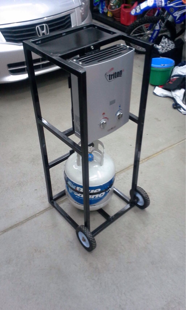

Postby Padilen » Wed Oct 14, 2015 2:51 pm
Please post when you get yours working your likes and dislikes.
This pic is similar to what my plan is, but I have an old pressure washer frame I hope to use.
I believe it's a form member's.
Padilen
Posts: 1536
