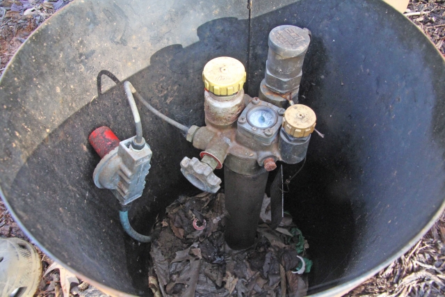

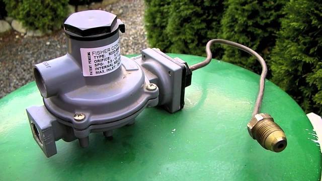

Walk out to your tank and look to see if you have something like this at your tank...
Dale

Re: home propane. There are a variety of propane regulators. At the large storage tank there could be a high pressure regulator that is red in color (10 psi pressure). If there is a HP red at the tank there will be a second regulator at the house. This will be usually be a brown color (1/2 psi or 11" WC). Sometimes this one might be blue (5 psi) with additional regulators within to drop down to the 11" WC. It is possible to have a integral 2 stage regulator but unusual for home propane systems. Running the higher pressure from tank to home reduces the required pipe size and saves money.

Dale M. wrote:
lrrowe wrote:When I saw the comments about the quick disconnect not being acceptable for high pressure connections, I got worried as my professional gas line installer gave me one for my outside grill directly from the 500 gal in ground house propane tank. I do have an on-off switch right before it though. It has been there for 10 years, but to be on the safe side, maybe I need to have it check-out by my yearly contract house service review. I never realized there was a difference.
Typically most gas grill runs at house/residential pressures (1/3 to 1/2 PSI) Turkey fries and such are a bit different as the can go up to maybe 15 psi....... Betting there is regulator at tank to drop pressure to safe levels... Check it out... Do not think any gas installer would run from tank to grill with no regulation....
Dale
Dale, I could not get your photo to post in this reply.
I have what appears to be a regulator in my system. 500 gal in ground propane tank. So I guess I am ok.
Bob

Postby Dale M. » Wed Feb 24, 2016 10:22 am
Yes you do have a regulator, all is good....
