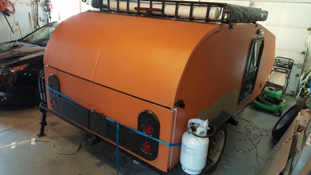

I am wrapping up my TD build and need to figure out what brass propane fitting I need to be shopping for. My galley area has a pull-out CampChef Explorer stove/griddle and I will have a 10lb propane tank mounted outside of the galley on the small rear trailer frame extension seen at the lower right in this pic:
With the propane line from the stove, connected to the OCV being under my countertop - I want to see if there is a through wall valve that would have a "male" fitting on the inside and a "female" fitting on the outside. Once outside of my galley wall, I could easily hook up to my tank with a short propane hookup. Any thoughts?

Postby Redneck Teepee » Mon Apr 04, 2016 8:45 am
There are all kinds of variations to choose from, a straight brass FxF bulkhead connector will give you a platform to end up with any connection you want.
http://www.amazon.com/Weatherhead-Tubin ... ad+fitting
Here's one that may help, it's also made for a quick connect which I highly recommend for convenience :
http://www.ebay.com/itm/PROPANE-NATURAL ... 1565184894
Best bet is to go to your local Propane Supplier, they should have a whole catalog of fittings, configurations and lengths to accommodate your wall thickness to look at. :thumbsup:

Postby Poorlytiedfly » Mon Apr 17, 2017 2:30 pm
I am still having trouble finding something long enough to pass through my trailers side walls. As shown here the LP tank is outside and just inside this wall is the pull out stove/griddle.
I have approx. 1.5" sidewalls to pass through.
