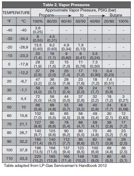

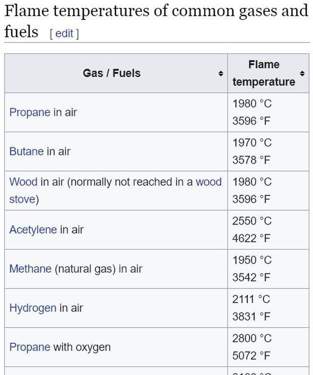

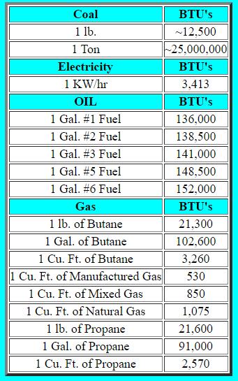

For most part stove does not care, both burn about same temperature (BTU) for practical purposes and its likely you will not notice any difference, only real issue is deliver pressure (in tank) at given temperature (but you as user will not notice)....
Temperature:
BTU:
Pressure/Temperature:
Propane press-temp.jpg (72.57 KiB) Viewed 6388 times
Dale

Actually when all other factors are equal it is competely the opposite.
> Propane has a lower boiling point than butane,  so it will continue to convert from a liquid to a gas even in very cold conditions, down to -45ºC. When stored as a liquid in a tank, it exerts a greater pressure than Butane at the same temperature.
Now I'm not saying your experience with your gear is not valid, but there is another factor at play, e.g. a small light butane canister warming up more quickly or something.
But mountain-climbers snow camping increase the propane proportions in their gas mix, while summertime pure butane is fine.
