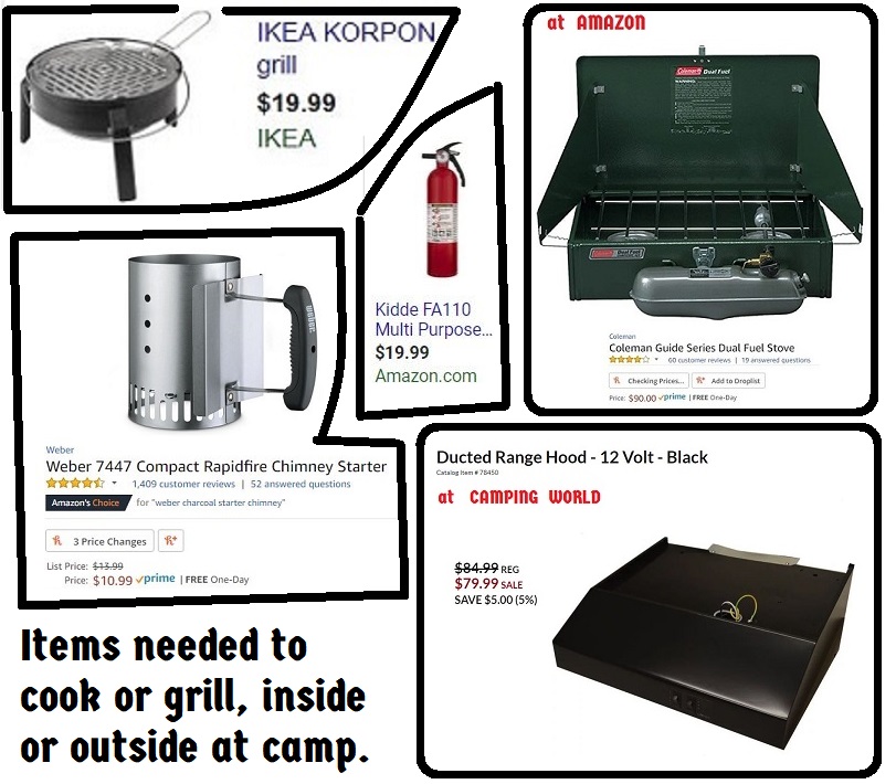

Postby working on it » Sat Aug 18, 2018 12:48 pm
Andrew Herrick wrote:While there is merit to both solutions, I lean on the side of a camping stove. There is a greater accessible variety in style, size and quality of portable camping stoves than of RV drop-in stoves. You can spend $40 on a Coleman or $300 on a Partner Steel. Plus, portable stoves are just that - portable! Why limit yourself to cooking in your galley on a 72-degree summer evening? Also, camping stoves can be removed from counters to make room for meal preparation....
  • I can see why one might want a stove/cooktop installed inside their camper...our 20-ft travel trailer has one (with the necessary ventahood over it), and it is perfect for the job, in a trailer you can spend several days inside, without ever going outside, if that's what you want.
  • But, in a smaller trailer, and/or standy, if cooking outdoors is what you want (nobody grills a steak inside if they can do it outside), the venerable Coleman white gas stove (there is nothing like the aroma of white gas cooking, at least to me) is what you want, plus a mini-sized charcoal grill. If I were building a small standy, I would install a stainless, or phenolic heat-resistant countertop, without the usual cooktop installed, and a similar shield on the wall behind, leaving a space to place your Coleman, or mini-grille on top. Of course, having a window close-by, an overhead ventahood on, and a nearby fire-extinguisher would be required, too. And a charcoal starter canister (initially used outside the trailer, to preclude tall flame-ups), for the small grille (my choice is the Ikea Korpon grill, which only needs a canister full, of briquettes).
  • Using these items, you could cook inside or outside, and still be able to use the bare countertop space for food prep before the fires are lit; there would be no propane lines to install and have to check for leaks before every trip, and having that bare spot inside the trailer would be golden, for many other uses between mealtimes.
    cook-grill items.jpg (177.11 KiB) Viewed 10783 times
173193172890148599
