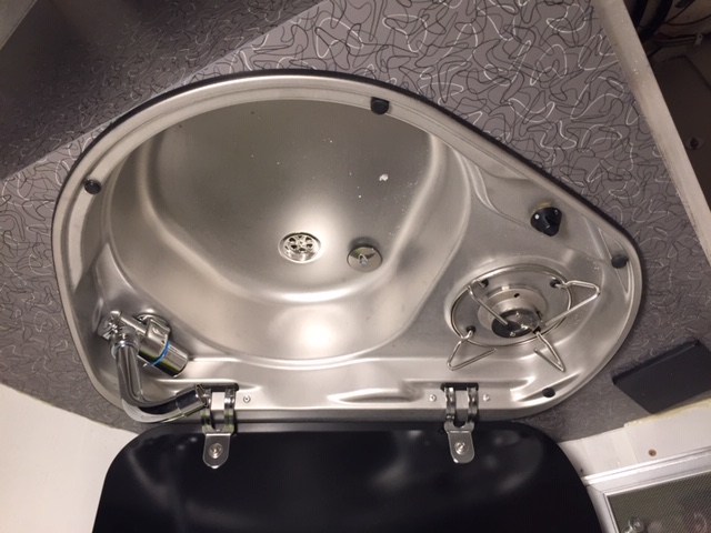

I recently bought a cute sink/single burner stove combo on Ebay. Looks great in my tiny trailer, and saves a ton of space. The problem I need advice on is connecting it. It has a corrugated (barbed?) pipe for the gas connection. I'm sure these work fine in China (whence it came) but apparently here a flared fitting is required. Any ideas on how to adapt it to a 3/8" flare, or failing that the safest way to connect it as a slip-on? Many counter people at RV stores have threatened me with an immediate and fiery death, so I want to get this right, if only out of spite!

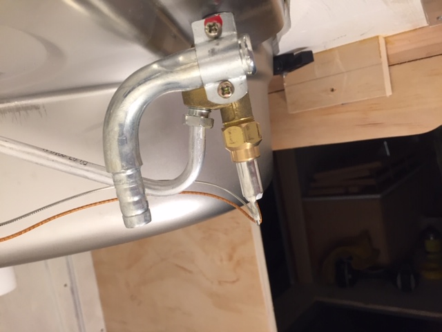

ohhh...I want to wade in on this one!! So, the hose fitting is held on with 2 screws and a "strap"I guess you might call it, right? So, what is the configuration of that L shaped hose fitting where the gas goes into the rest of the control unit, the brass part? What the heck makes that weird cornbinder fabrication gas tight? Gasket? O ring? Gorilla Glue? no, I got it, chewing gum!!
What I am kind of getting at, is there a way to replace that aluminum? L part with a capped piece of maybe 1/2 copper tube with a flared end? Or any size of iron pipe? 1/4? 3/8? Take it apart and post a pic for us??? I tell ya, I'm dying to see what the design of this connection doodad is! And there are a lot better engineers than I on this forum who might weigh in...
Tear that sucka apart and put some pics on here for us Curious Georges, pullleease!!???? :worship: Nodrog

Postby Richrad » Fri Jan 11, 2019 12:59 am
Thanks to all, especially Ack for the shopping list! And to nodrog (just so you can sleep at night): that tube sits in a sort of saddle clamp, which seals with a small O-ring against a hole in the burner casting. No chewing gum :lol:
