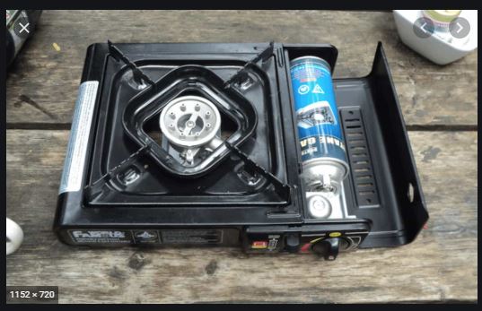

Looking at stoves, now.
The "lunchbox" stoves that run on a slip-in 220g butane canister are rife in my part of the world.
Singles and double burners.
Single butane.JPG (46.78 KiB) Viewed 6285 times

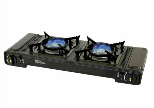

The double burner, 2 can, propane stoves are simply left and right hand versions of single burner butane stoves joined together. With the cans at each end.
This makes them very long.
2 burner butane.JPG (23.08 KiB) Viewed 6285 times

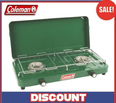

Next step up is the Coleman type stove that runs on the screw-on 1 lb. bottle of propane/lpg
These range from the small basic one as below, on up to veryy flash ones.
The little green coleman above is compact, about the same price as the 2 burner propane stove, has at least part of a windshield (the lid) and will fit where I want to go.
But - those green 1lb gas bottles are not cheap in my part of the world. I can buy a 220g can of butane for $1.50 or less.
a 450-ish gram coleman propane bottle ranges from $9 to $15. So anywhere from 3 times the price for a given weight of gas, upwards.

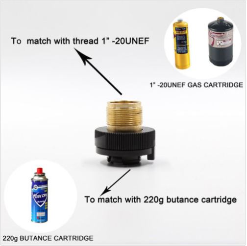

So the little green Coleman, and a couple other basic stoves available locally, uses one of these:
coleman regulator.JPG (15.82 KiB) Viewed 6280 times
Now, online you can buy adapters that will convert 220g can to a Coleman type thread:
So, at that point, you have a butane can (very cheap) connected to your coleman propane stove (also very cheap, and the right size for my application).

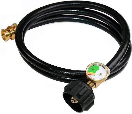

You can also get an adapter hose that allows use of the 1 pound propane cylinders as well as any that uses the standard POL connector. I bought a 5 pound cylinder for my little trailer, to power my two burner stove.
Something like this will do it.
I also sprung for the Flame King refill kit and cylinders which allow safe, legal refill of 1 pound bottles. Good stuff.

Postby MickinOz » Wed Mar 03, 2021 3:23 am
So today, I received my butane adapter.
This one:
So I hooked her up, opened the valves and lit the burners on the vintage primus.
They ran OK, but I could hear and see that the flow was greatly reduced.
I filled the coffee pot to the first hole, put it on the stove, hit the timer, inserted a thermocouple in the water and put the lid on.
Time to reach a rolling boil at an indicated 99.3 C was 20 minutes.
Only a couple of grams of weight loss on the butane canister.
Then I set up the experiment again, this time with the propane.
Clearly more than double the flow.
Time to reach boiling at an indicate 99 degrees was 6 minutes
Again only a few grams of weight loss.
So first conclusion re: adapting butane to propane:
"Cylinder pressure" stoves, i.e. unregulated stoves, have quite small jets that flow the right amount of gas at propane cylinder pressures. Butane cylinder pressure is incapable of pushing enough flow through the small jets.
At test conditions propane gas pressure is around 860 kPa, while butane has a pressure around 215 kPa.
Flow rate, all other things being equal, is pretty much proportional to the available pressure.
So, butane isn't much good in a stove built for "cylinder pressure" propane. I'd have to re-jet, I'm thinking.
The next thing to try would be a regulated pressure stove.
Seems a coleman regulator outlet is around 110 kPa, so the cylinder pressure of butane should be enough.
That test will have to wait, until I come across a suitable stove to try.
