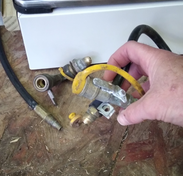

This may not be much help but will throw it out there. I don't know anything about these but the hose has a 3/8 flare on one end and a quick disconnect with a valve on the other end. The other is a frame mount with flare on the inside and QD and valve on the other.
Pulled these off a salvage pop up. I don't have any use for these two fittings. Offering them on my wife's Marketplace. They may be able to be made at an RV joint.
Tim
