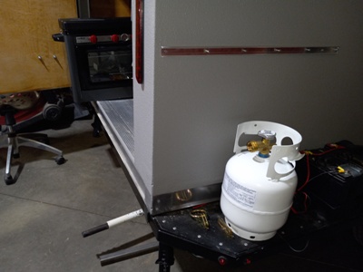

Postby Tom&Shelly » Fri Feb 18, 2022 7:01 pm
We just got our AT overland bracket this afternoon. (Actually, the UPS driver took one look at the road to the cabin and decided not to chance the mud. I saw him and took off after him in the Jeep; otherwise we wouldn't have seen the bracket until March!)
168346 168345
Better than the prototype photo they have on their web site, since in that one they messed up the holes for the rubber baby buggy bumpers and some were right in line with one of the straps. They fixed that. Even better, now they stamp their logo through the wings! :thumbsup: (I wondered if Tony's has that "feature" but couldn't find any pictures of the bracket without the tank.)
They include the black tape along the back to keep from marring whatever you bolt it to. Won't work for us though. We want it mounted next to the front cargo door
168347
but that's a hollow front, with a 16 wide x 15 inch tall block of foam in there. The tank bracket is only 12.5 inches tall, so we'll need to mount it on something and then mount that through the wood frame above and below the foam. (Also avoiding some wires that run through there.)
First thought was to use a 1/8 inch panel that I have from a 19 inch electronics rack. That's the lovely green painted panel leaning against the tongue in the picture. I think that'd work, but not sure how big of flat head bolts I can find where the countersink is only 1/8 inch thick. Another option would be a mess of 4-40 or 6-32 bolts, threading the holes in one piece of aluminum. That's basically what I did to build the battery boxes.
Might be better though to use a scrap piece of 3/4 inch plywood, maybe with T-nuts on the back, and bolts through the plywood and through the front of the tear, with washers and nuts in the utility compartment. I can line the through holes in the front with epoxy, and maybe glass and epoxy the plywood.
174145 170466 173366

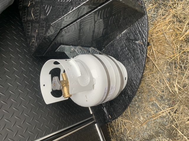

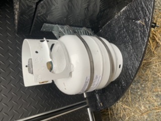

Postby TearDropDrippin » Sat Feb 26, 2022 5:39 pm
Here is what I ended up going with. What do you guys think? $20! Water expansion tank bracket form Lowes.
TearDropDrippin
Posts: 16
Joined: Thu Sep 09, 2021 1:48 am
Re: Suggestions for mounting a 5Lb propane tank?
Postby TearDropDrippin » Sat Feb 26, 2022 5:42 pm
Another view. Still learning how to post pics on here.
