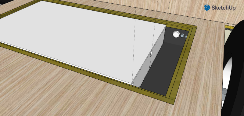

Greetings friends,
I am in the midst (year 2 ) of designing and building my very own teardrop trailer. I am ordering the little water tank on Monday. This is a small tank, only 11 gallons installed right above the axel and under the bed. I am looking for a solution for a decent water level gauge. I can't use a simple closed tube because the the tank location. I could a tube on the side inside the compartment (see picture) but I would have to lift the bed and open the lid to see it. I need something electrical that comes in from the side. I also want to keep the cost down. The tank is from Plastic-Mart and is a model: R-RVB319. It will have the fittings installed where I choose. I have figured out my fill, vent and drain locations and wondering if I will need others for a gauge. It's not a huge issue and not a critical item, however, if I can find an easy solution I would consider it. Thanks all!
Water Tank Detail.png (322.84 KiB) Viewed 13263 times

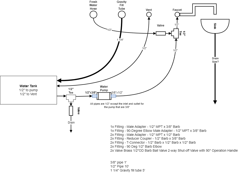

Also, since I am posting on the subject, here is my basic plumbing schematic.
Plumbing Scematic.png (77.63 KiB) Viewed 13263 times

Postby bobhenry » Sat Oct 05, 2024 10:15 am
Your tank needs a vent to allow air in to avoid vacuum locking your tank as the water is pumped out right! So add it near the bottom of the tank. Now extend it to the exterior wall and using clear tubing extend the vent outward and up the exterior wall. As you start to fill mark the low point and fill to the top and mark the full right on the side of the trailer. A cabinet cup pull could be added as a protective awning over the end to divert falling debris or a simple cane hook return you now have an ultra simple combination vent with overflow protection. While adding this put a tee in at the lowest point and a valve to dump the tank and as a rinse out or drain for winter.
