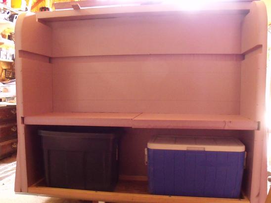

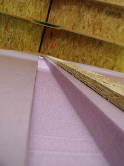

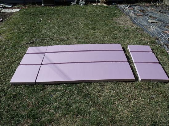

I have used a hot wire to cut grooves in the foam for bulkheads and shelf support. Could be easy to cut something similar for the floor to slide into.
Groove
DSCF1759 small.jpg (54.92 KiB) Viewed 22554 times
Groovy
DSCF1760 small.jpg (100.47 KiB) Viewed 22554 times
Shelves
DSCF1801 small.jpg (58.38 KiB) Viewed 22554 times
When you do you 1" and 1" make sure you allow for thickness of paint and canvas! Sounds good on paper, but when in application, not! I would probably allow at least 1/4" for allowance. Unless you do not plan on canvasing between the two pieces.
George.
