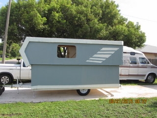

check out these
http://www.tnttt.com/viewtopic.php?f=50&t=60054
http://www.tnttt.com/viewtopic.php?f=50&t=59418&p=1072827#p1072827
There are other "Lifting Roof" designs at this link
http://www.tnttt.com/viewtopic.php?f=5&t=50969
and you can find many ideas (not limited to foam) in my thread on unusual designs
http://www.tnttt.com/viewtopic.php?f=5&t=64495&start=15
Ohh, and let's not forget the trailer that seems to be the original foam build on this site, it was a "High-Low" design and kicked off the foam craze that later lead to creation of the "foamie" section . See this link http://www.tnttt.com/viewtopic.php?f=5&t=19227&hilit=coalburner

The BUB !!! 8) :thumbsup: There was a Fiberglassed Foamie before that .... Guy named Glassice made it , then disappeared... :o

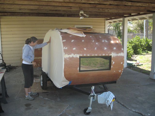

As far as I can tell BUB was the first build to draw attention to building the trailer using a foam core without a mold and (almost) no wood! And he supplied a lot of pictures of how he did it. That's what made BUB so special. You deserve a lot of credit for making the concept affordable (using TB2 ala laursand etal Image - I first saw it here http://www.tnttt.com/viewtopic.php?f=55&t=39373&p=733680#p733680 in your long thread classic) a few years later. I find them both significant additions to the art.

Yes, it did float. I remember looking everyday to watch his progress, but, I figured it was overbuilt or at least far beyond what I was willing to invest into something I had never tried. I was even more excited to learn of the fabric/TB2 in the Laursand post in your big thread.
