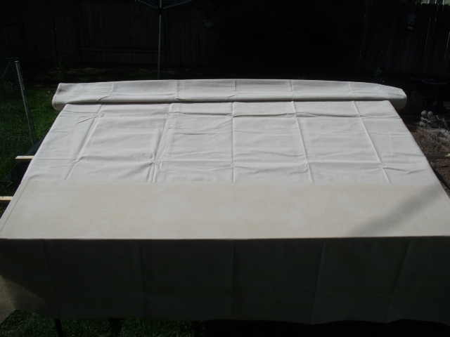

I have had good luck with the HF 9"x12" drop cloths. http://www.harborfreight.com/9-ft-x-12- ... 38109.html . I just noticed that they are rated at 10oz. $16.99, use a 20% off coupon and the price drops to 13.59. It does have a seam down the middle, once you cut that out you have two 6'x9 pieces of canvas. Perfect for a standard 4x4x8 or 4x5x8 sized TD. I do not wash the canvas and like how it shrinks when applied. Wrinkles are easy to roll out.
canvas
As far as prewashing for interior I did not bother. Came up with a good method for interior work. May take a few more steps, but real easy to do. If interested you can read about it in my build thread. Ceiling starts about halfway down and walls follow. http://tnttt.com/viewtopic.php?f=55&t=54099&start=600 .
