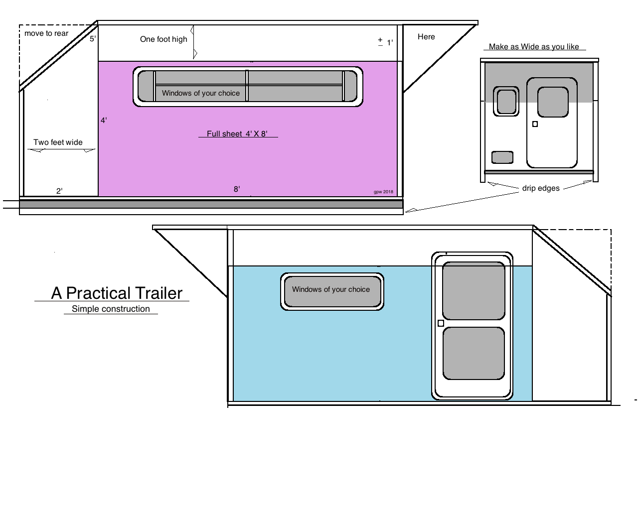

Always thinking about the simplest and most Practical way of doing something , we’ve done yet another drawing trying to best utilize time and materials . Thrifty , and be simple to make , no Complex cutting save the front angled nose , just two angle cuts … Not That difficult with a bit of measuring and sanding …
Nothing fancy , just optimum sized (subjective, naturally ) foam box proportions ... 60 sq. feet floor space, 60” tall inside . You could do any inner framing you like … Just don’t make it too heavy …
Simple as it is , it doesn’t have to look it , just a nice paint job does wonders to dress up the simplest cracker box … ;)
And it should be garageable ...
For your consideration …
Practical TTT .png (67.78 KiB) Viewed 1388 times

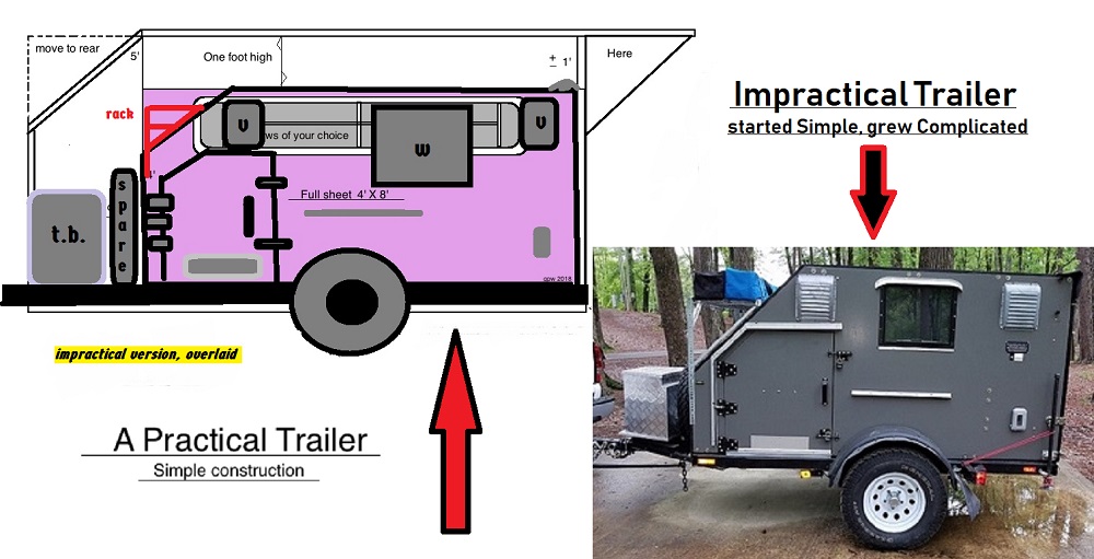

  • Looks great; if only I'd known that my "practical, yet simple" ALL PLYWOOD, NO FOAM design would soon become so convoluted, and crammed with so many ad hoc features, that it would not be practical for me to use. Or easy. You have a simple pattern here, that would work, with or without using foam panels.
  • It's hard for me to get in and out, since I've gotten older and less flexible, and though I wanted to build the traditional-sized (not traditional-shaped) 4x8, I sure would like to have an extra foot in height, two feet in length, and perhaps an extra foot in width, that your plan offers.
  • But, as a newbie trailer-builder, and unaware of my looming rapid aging process, I blithely built it "my way"; to paraphrase Yogi Berra, "I made too many wrong mistakes".
    Practical TTT made impractical.jpg (141.19 KiB) Viewed 1209 times

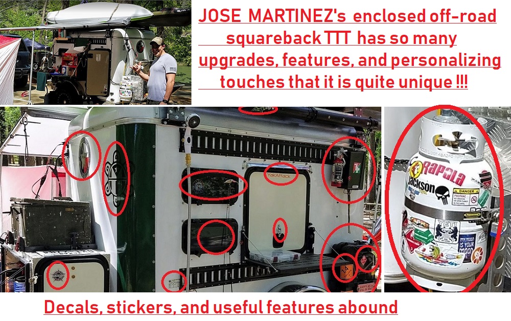

  • I'm in the midst of a frenzy of mods before my next trip, the rod & reel carrier being one of them; and I started adding more usually whimsical, but always reflecting in my sort of whimsy, stickers and decals that I've made for the trailer, since I've always liked that sort of thing. I was spurred-on to add some after viewing Jose Martinez's great little trailer, while camping at Beaver's Bend...he had added unique personalizing touches everywhere, that also reminded me of the drag racing stickers I have on my race car. I already have several on my TTT, but Jose has at least two dozen, making it quite unique.
    tribute to Jose's trailer.jpg (319.8 KiB) Viewed 1130 times

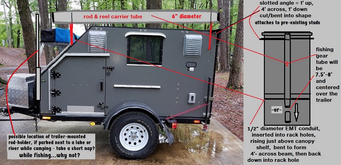

  • Here is the planned tube on the roof, inspiring my name re-definition. I'm old and retired, and do basically what I please...a little personal "madness" shouldn't offend anybody, so why not?
    tube placement.jpg (265.44 KiB) Viewed 1130 times

Well Dadgum, all this time I thought you pulled it with an HHR (high heritage roof)
GPW,
I'm studying the little triangle that was moved from front to the rear. Is that similar to Shasta wings or does it serve a purpose? I'm dense and trying to figure this out.

  • Actually, it almost was, and the name was intended to be a double entendre. I started out building the HHRv to be pulled with either of our daily driver cars: her Cobalt, or my HHR Panel. It was not to be, though.
  • When planning for the trailer to be towed by either of the small vehicles, I tried to get some aero benefits if I could, like those gained by using a teardrop shape, but sorta in reverse: by 1) trying to hide the TTT in the wind shadow of either of our Tow Vehicles = the Cobalt (@55.5 inches roof height, and roughly 40 inches at the trunk), or the HHR Panel (@63 inches roof height), with the trailer's front wall starting to slope back at that same 40 inches as the Cobalt's trunk, 2) keeping the trailer narrow, at 4 ft, less than the width of the cars, and 3) I tried to get a Kammback spoiler effect, to disrupt suction/drag, on the rear, for additional aero benefits. The Kammback was formed by using a semi-rigid piece of conveyor belting to create a partial Kamm effect.
  • The HHRv ended up way too heavy to be towed by either car (1600+ lbs at first completion, way over their tow limits of 1000 lbs each), so my '04 Chevy 2500HD pickup got the job. Neither the aero planning, nor the naming rationale were warranted, after the big truck got the tow vehicle job, and I got sole usage of the trailer. But, the name stuck, anyway.

HMK , that forms a small rear roof overhang to keep the weather off the rear entry doors … ( optional , but nice in the rain … )
( and was a perfect use for the scrap off the front … ( nothing goes to waste ! )
