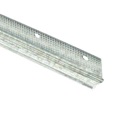

Postby ghcoe » Fri Aug 14, 2020 1:14 pm
Shirestone wrote:Sorry for all the confusion but I just want to make sure I get this right and don't have any water infiltration.
Attached is the end view of the foamie i'm building.
The pink is the foam..the brown is wood and the lighbrown is plywood. Black is the trailer.
my plan is to wrap canvas around the foam and the plywood underneath. The canvas underneath will go about 2"-3" underneath onto the plywood(canvas not shown in image). I am then planning on some hardwood strips under this (not shown) between the plywood and the trailer. This was suggested by ghcoe I believe so as to prevent rubbing of the canvas on the metal frame.
I am then planning on a metal drip edge around the perimeter shown in white. My question is...what is the best method to attached the metal bead or drip edge to the canvas. Im thinking caulking or possibly pl300 and then caulking along the top edge to prevent water from getting in behind. Please keep in mind i am in canada and glidden gripper cannot be obtained here, so that's not an option.
The drip edge i am planning is slightly different in that there will actually be a folded edge to it so that it drips downwards. It's not shown on the image below.
Thanks all for your help.
162921
I would just use a drywall end piece like this (pictured). I usually use Dap Latex Caulk to seal between the body and the drywall corner bead. Screws to screw it to the bottom of the plywood.
I can see a issue with your planned canvasing of the sides to the floor. If you do not angle the plywood edge to the angle of the incoming wall angle you will get a delamination there. The walls and floor have to be situated so that the canvas can apply grip in shear. With a step like that the canvas will delaminate from the foam as outside forces are applied to it. In fact I venture to say you will have problems as the canvas dries and shrinks.
George.
