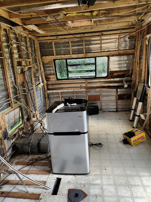

Fwiw and in imho, would NOT do the exterior in PMF but instead use the existing exterior for simplicity and cost saving.
You'll have so much work gutting and redoing the interior that you will be glad not to have to do the exterior on a trailer that large. You might also run out of funds.
Use that time and money to go camping! :D

That is very sensible advice, and thank you. Being kinda near-done with the gut, I'm realizing how much work there was and how much is left to do, so scaling back would free up more time and money to go camping, I hope. And sooner, rather than later. :worship: I think the world may be imploding.

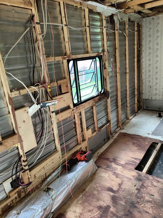

Question, though: the studs are 1 1/2" wood, and the pink foam will be cut to fit the gaps. If I keep the exterior (aluminum sheet, I think?) in that scenario, I'd only be able to canvas/glue/paint the interior. Given that there will still be plenty of wood framing, I'm hoping that the structural integrity will still be solid. What do you think?
I'm glad the fold out porch, roof, and "railings" will all be real PMF, at least.

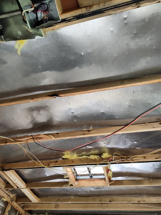

I'll see if I can attach a coupla pictures of the current state of the gut. Next, it's pulling up the partially rotted floor, as well as removing the dead a/c. Then the fun part can begin!

Not a "foamie" anymore, little need for canvas at all, luan liner or one of the synthetic sheets.
Find your local spray foam insulating outfits, do all the taping prep yourself let them know you will scrape & clean up the excess
get prices for a quick side job, you bring it to where they are already set up doing a house on a nice hot day.

Thank you for that good advice. One of the goals for this was not just it being a foamie, but building something myself. So I might stick with the foam, even if it's harder and looks worse, for that lone reason. We shall see.
But you're quite right, it's not a foamie anymore. And because of that, it's not appropriate for this forum anymore. If I ever do finish this thing and use foam for anything other than between the studs, I'll post a few pictures. Other than that, I'll stop posting and continue to be grateful for all the advice I've been given here.

And JMHO , although we Love those aluminum sided trailers , If they only treated the wood inside , Most of these problems wouldn’t happen … That and they don’t use the best wood either …
