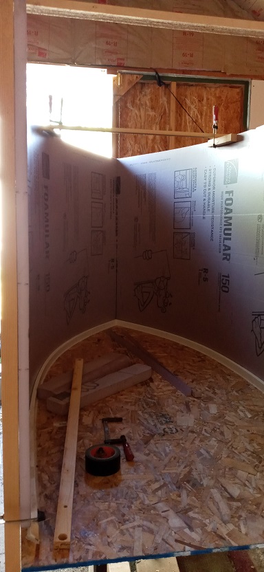

Walls mocked up for window placements.
Walls
20210626_104101 s.jpg (359.92 KiB) Viewed 2494 times
Walls #2
20210626_104120_HDR s.jpg (351.71 KiB) Viewed 2494 times

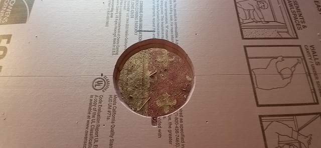

Once I figured out where I wanted the windows I cut them out.
Window
20210627_094126 s.jpg (330.02 KiB) Viewed 2487 times

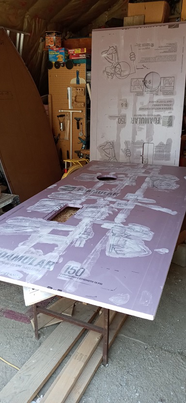

Then the spackle to smooth things out on the printed side.
Spackle applied
20210703_130206 s.jpg (390.06 KiB) Viewed 2487 times
Then a sanding to smooth the walls out.
Spackle sanded
20210704_083004 s.jpg (465.01 KiB) Viewed 2487 times

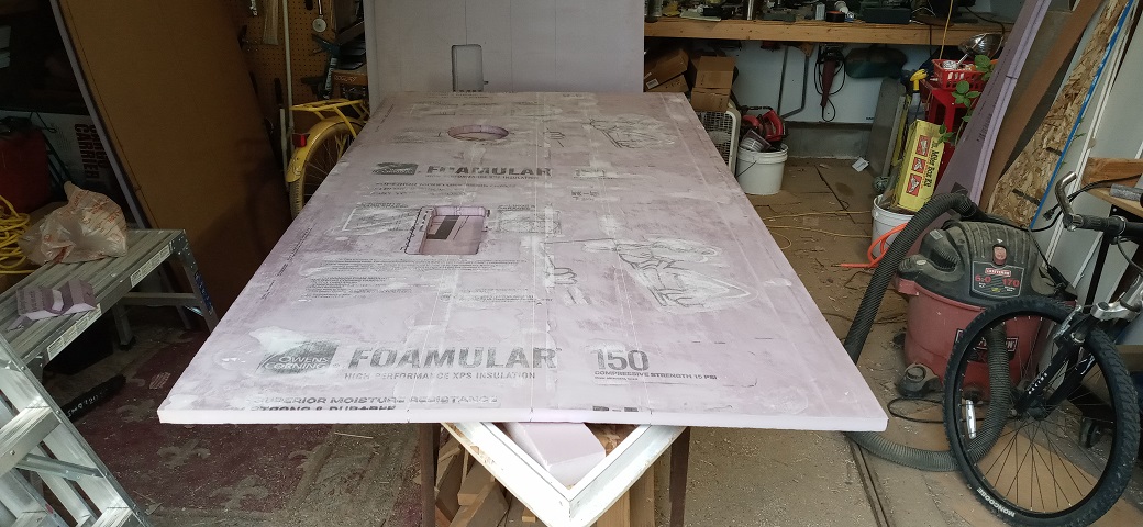

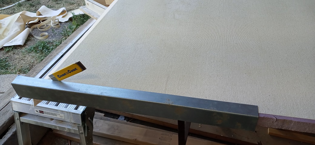

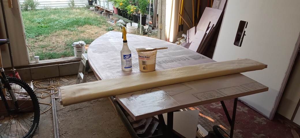

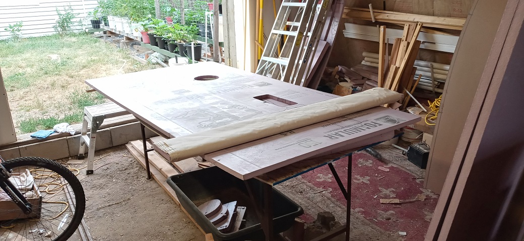

Then it was time to cut the canvas to length.
Unrolling the canvas
20210704_085416_HDR s.jpg (404.61 KiB) Viewed 2487 times

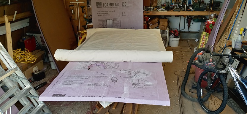

Then roll up the canvas and get it ready to be glued down.
Ready for gluing up
20210704_091044_HDR s.jpg (492.45 KiB) Viewed 2487 times

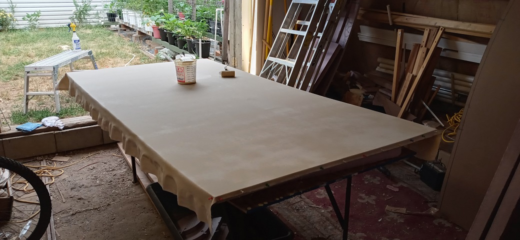

A hour later we have a canvased wall.
Canvas glued down
20210704_104135_HDR s.jpg (441.92 KiB) Viewed 2487 times

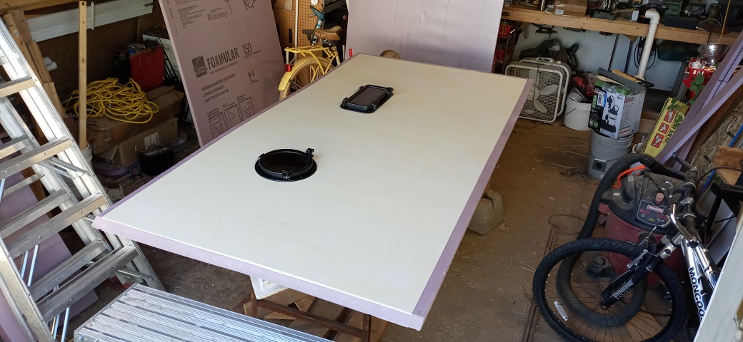

Once the canvas is dry I cut back the canvas where glue will be applied for assembly and cut out the windows.
Trim canvas
20210705_094734 s.jpg (481.61 KiB) Viewed 2483 times
Then a quick test fit to make sure the windows fit properly with the canvas installed.
Test fit
20210705_100211 s.jpg (440.61 KiB) Viewed 2483 times

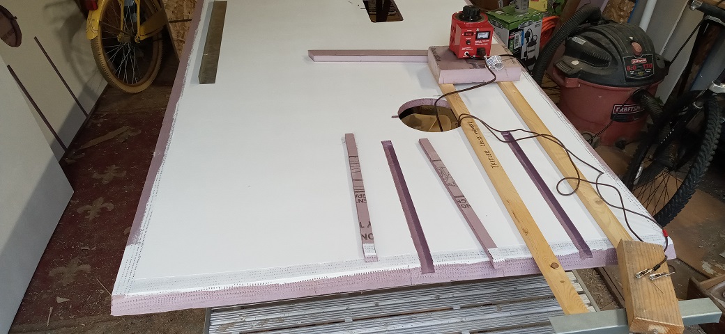

Not to much got done this weekend as far as working on the trailer.

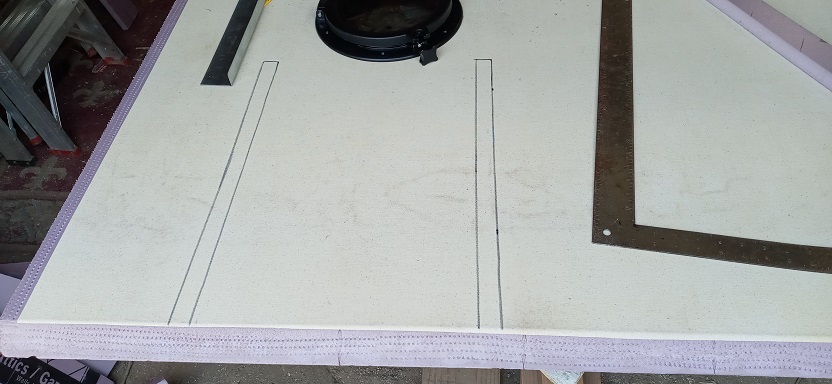

I basically only got to cutting the excess canvas off the other wall and prepped up some templates and a hot wire cutter for the shelves.
Shelf cuts marked
20210711_115915 s.jpg (364.48 KiB) Viewed 2378 times
I am adding two shelves to the front of the trailer.
Shelf cuts cut
20210711_125203 s.jpg (371.39 KiB) Viewed 2378 times

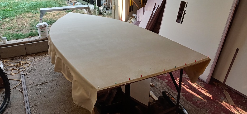

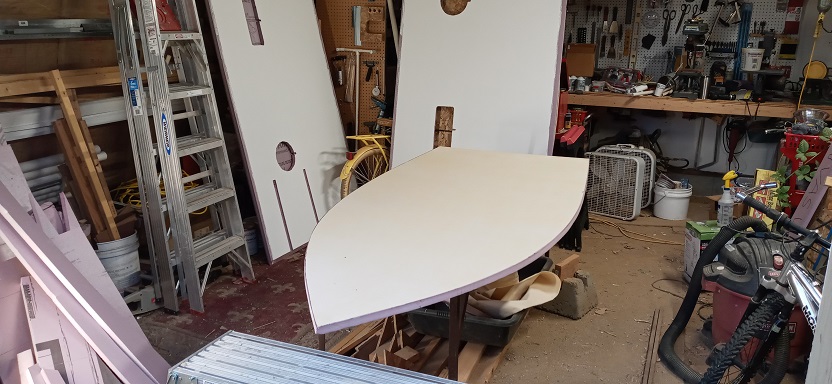

Progress this week.
Applied canvas to the ceiling side of the roof panel.
Applying canvas
20210718_081203 s.jpg (464.43 KiB) Viewed 2157 times
Canvas applied
20210718_085930_HDR s.jpg (443.01 KiB) Viewed 2157 times
Once dried I trimmed the excess canvas off.
Canvas trimmed
20210719_070042 s.jpg (393.2 KiB) Viewed 2157 times
George.

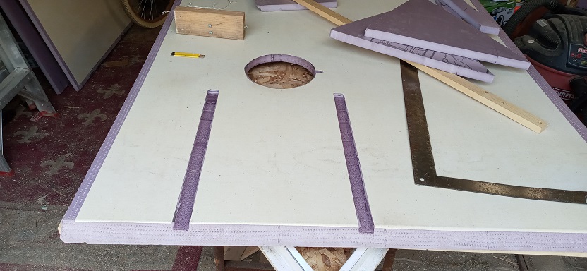

Postby ghcoe » Sat Jul 24, 2021 7:58 pm
I had forgot to cut out the left wall shelf dados the week before so I had to cut those out.
Cutting dados
20210719_075940 s.jpg (437 KiB) Viewed 2155 times
