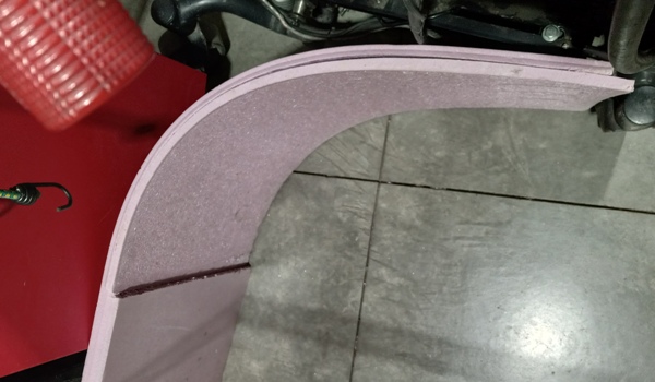

An old test on 1.5" cut twice, three 1/2 vs bent pretty well till it didn't.

Did you bend the pieces together or separately and then glue. I think you may find if you restrain the ends of the piece you're bending it will better conform to the curve. I've used that making wood forms with sheet metal binding the outside.

Postby twisted lines » Mon Feb 27, 2023 8:05 am
pchast wrote:Did you bend the pieces together or separately and then glue. I think you may find if you restrain the ends of the piece you're bending it will better conform to the curve. I've used that making wood forms with sheet metal binding the outside.
Only a 4’ wide cut test, while playing with it; pulling to test how to glue, snapped it. That piece is only squeezed like that.

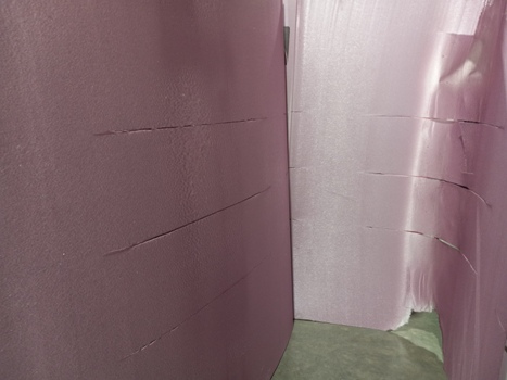

Postby twisted lines » Wed Mar 01, 2023 2:24 pm
Is cutting the other way any better where the snap lines are?
The concrete is on top!
Didn't help :frightened:

Postby GPW » Mon Mar 20, 2023 4:56 am
Just a note : When bending foam to the extreme , the outside of the bend is most venerable to cracking (Tension) . So the easy thing to do is put some kind of tape on the outside , even cheap packing tape will take the tension loads and prevent cracking while bending . Fiberglass tape while more pricy works the best ... Even with kerfing' , tape works !!! ;)

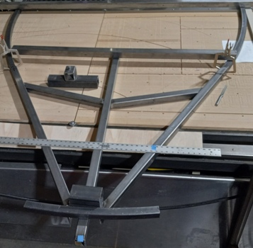

Re: Another idea from the sketchbook ...
Postby twisted lines » Tue Mar 28, 2023 2:58 pm
The 4' rule tells all, forward is the 10 lb'r
Behind it inside; 15'.
If you measure like a boat, within inches :lol:

Postby twisted lines » Fri Apr 28, 2023 10:15 am
GPW wrote:Just a note : When bending foam to the extreme , the outside of the bend is most venerable to cracking (Tension) . So the easy thing to do is put some kind of tape on the outside , even cheap packing tape will take the tension loads and prevent cracking while bending . Fiberglass tape while more pricy works the best ... Even with kerfing' , tape works !!! ;)
I kept this in mind yesterday; Thanks
Tape worked very well :thumbsup:
