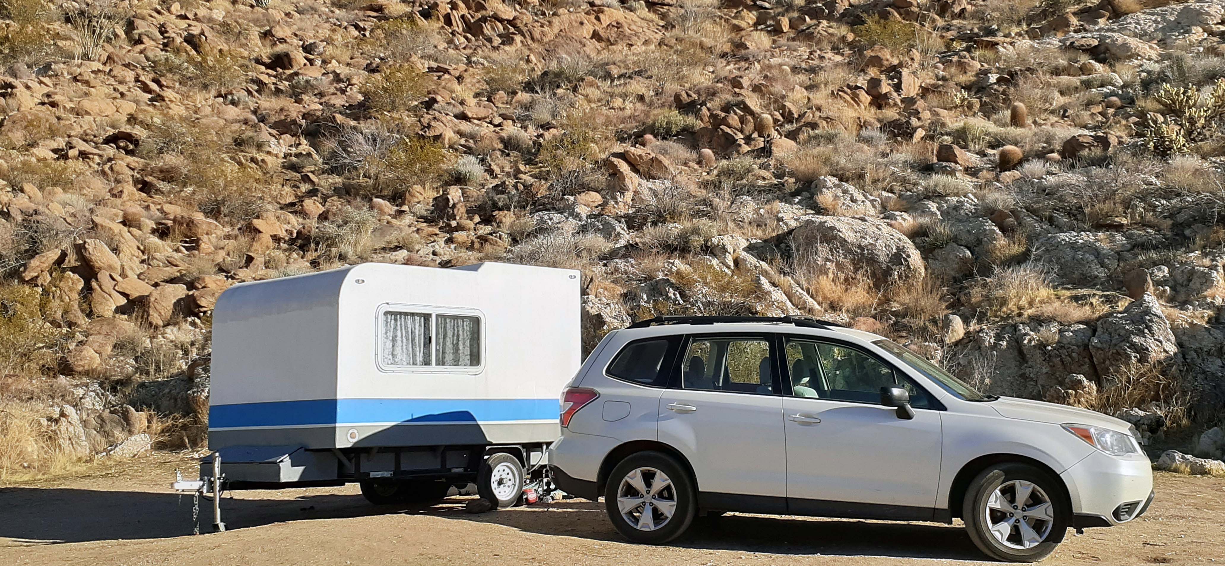

5 Year Update
Postby ScottE » Wed Feb 24, 2021 10:30 am
5 Years have passed since building my foam Camp Capsule! No leaks, no cracks, paint still looks great, tows like a dream! I moved the spare tire from underneath to the rear bumper mount, originally designed for our bikes, for off road clearance. We now use a battery powered pump for our fresh water as it's simpler and much easier to use. I highly recommend the use of LED strip lighting as my house battery lasts a really long time! The built in USB charging port is a great feature and other campers in our family love to use it when in a group. The insulation in the ice box isn't up to par with modern standards and we routinely use a good ice chest for cold food/drink storage. I'm in the process of designing an external rear mount for a portable BBQ grill to keep things clean when packing. Overall, foam/canvas construction has proven to be very robust and durable!

Just returned from a 4 day stint at French Camp in the Sierras. Trailer did a fantastic job keeping us warm in a beautiful place. Planning to paint soon, and do some cosmetic upgrades (eyebrows over the rear windows, and bracing my homemade door), but she's as structurally sound as the day she was finished!172061
