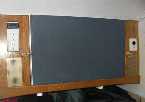

I was inspired by the fabric/glue methods being used here, and decided
to test it out. I posted this way back in the Big Thread, reposting it here
hoping someone might find it useful. I am a big fan of creating multi-
purpose elements to save weight, and I think things like this could be
incorporated nicely into a foamie design...

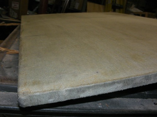

I chose plywood for my table because I had a scrap of the perfect size,
and because I did not expect foam to provide a surface that was sturdy
enough for food prep and a big knife. Now I wish I had tried foam,
because the finished surface is solid, durable, waterproof, chop-proof, etc.

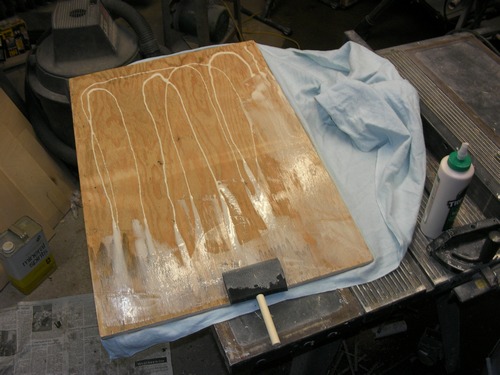

Materials I used were Titebond 3 and a old flannel sheet. I chose T3
because after reading the specs I was convinced it would best handle a
spill of boiling liquid. I did not want to paint it, since the T3 is
supposedly suitable for contact with food, but it was so ugly that I
brushed on a coat of exterior paint. The table held up well to grease
drips, blazing sunshine, hot tea cups, and even a pot of beans that
boiled over on it.

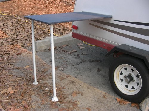

The table remained attached to the side of the trailer when camped,
and even in extreme winds, I just weighted it with rocks and/or jugs of
water. If it were made of foam I think wind would be tricky, but that
would be the only drawback.

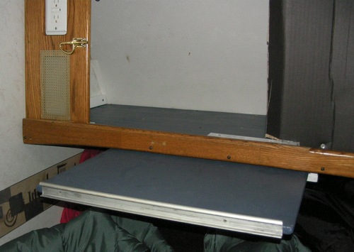

My table attaches vertically to the front of the cabinet for travel, and it
slides into supports under the cabinet for use on a rainy day as a laptop
shelf for watching movies.
Conestoga

Ratkity, your table is certainly more stylish than mine. Why is it bowed?
My table is a piece of old ratty plywood, but it has not bowed at all being
outdoors, and I credit the glue, fabric &paint.
The hinge I pillaged from a very old RV in the salvage yard. Great place
to look for project parts.
Conestoga

Postby Conestoga » Mon May 16, 2011 2:25 pm
Ratkity, thanks for the link. That stuff is cheap, 5 bucks for 30".
Apparently i saved less than minimum wage on the pillaging, lol.
It looks like you mounted your hinge properly. :D

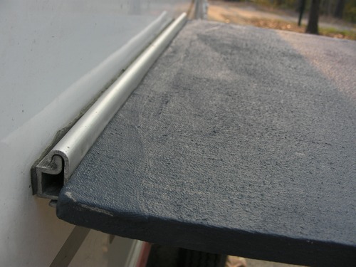

I was paranoid about the screw holes so i used gray butyl tape
behind it, :duh and the hinge squishes into it and gives under the
weight of the table, unfortunately, and the table sags without the legs.
Maybe because I have the hinge halves reversed?
I don't know if it would make a difference. I suppose i should
switch things around and see what happens.
Conestoga
Posts: 261
Images: 22
Joined: Wed Dec 30, 2009 12:01 pm
Location: Central PA

I think any table needs support underneath it, even with the hinge (no matter how it's mounted). I wouldn't want anyone to sit on mine, but the wood does sit directly on the fender, giving it extra sturdiness. I would hazard a guess that it could hold 50 lbs easily.
BTW, my table is about 33 inches long and 18" wide. Perfect for holding the stove and the electric kettle. All I did was cut one edge straighter and that was all I had to do to size it. I happened to have a rattle can of polyurethane that was nearly full and used it all on the table, or probably would have painted it with something I had on hand. All in all, the table cost me the $5 I spent on the hinge.
I used GOOP sealant and adhesive on the hinge (TD side) and made sure the screw holes and edges were covered very well. I doubt that hinge is going anywhere.

Postby Conestoga » Mon May 16, 2011 2:51 pm
Thanks for the tips Ratkity. I'm going to remount mine.
I used butyl tape on my first attempt, because i wasn't sure what would
happen. I think i'll get better results with an adhesive like you used that
is more permanent. I have the removable legs because of how the
table gets stored on front of the cabinet. With a rock or two under the
feet, the table is always level :-)
My table is 20 x 31"
