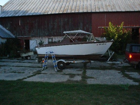

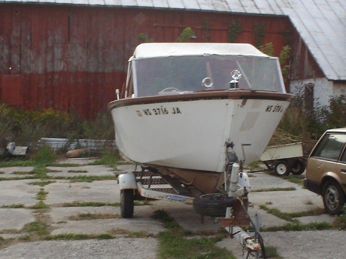

so some basics of what i have to start its a shore lander bunk boat trailer
the oal is 18 feet long
the axle is 4.5 feet from the rear or 13.5 from the hitch ball
the axle is 7 feet from outside to outside
we are looking at building 14 foot long and 6 to 7 foot wide

Postby jmkjr72 » Sat Feb 02, 2013 9:32 am
aero wise we might not make it a full standie we might just do a drop floor in part by the galley area just depends upon how it matches up with the trailer
and we might round it up a little more and try and keep the inside of the cabin right around 6 foot wide this should keep the cabin between the wheels if not then i will go just wide enough to have the wheels even with the outside wall
our donor trailer
