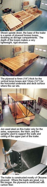

Postby dogeron52 » Tue Feb 07, 2012 10:07 pm
http://tnttt.com/album_ ... c_id=87519[img]
this is one approach
Dog52[/img]

Postby dogeron52 » Tue Feb 07, 2012 11:13 pm
http://www.epoxyworks.com/indexprojects.html
non marine use, projects from Jon Staudacher
Dog

Postby dogeron52 » Tue Feb 07, 2012 11:17 pm
I am trying to design a trailer similar to this. With a trail manor type top to fit in the garage.
Dog
