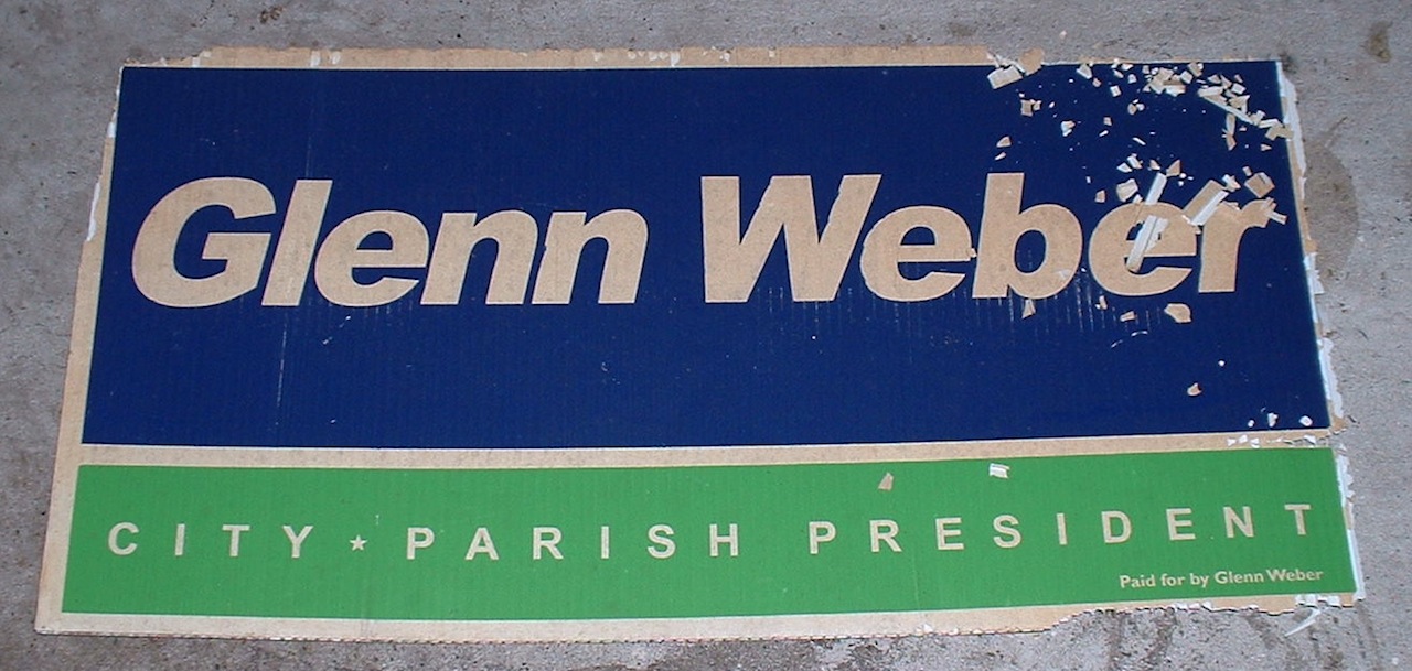

Tund’, JMHO , there are Better materials to use than Coroplast ... which so far doesn’t survive the aging test ... it gets brittle as it ages... :o Samples even tested Inside show similar results, sunlight only accelerating the process.
We have however, made short term projects , like RC model planes of Coroplast , and they worked fine...usually crashed and retired long before material degeneration .. Things like Coroplast dog houses and shed walls didn’t last so long ... for us :oops:

Now it may be possible there are different qualities of Corroplast ? The material we’ve used and seen deteriorate was re-used from left over political signs ... some 4X8 sheets ... the pieces I have , stored on a shelf in my studio for 5 years now (no sun) , on some of the edges , crumbles like a cracker ... I just broke off a piece with no effort (see pic) ... Take that for what you will ... :thinking:
