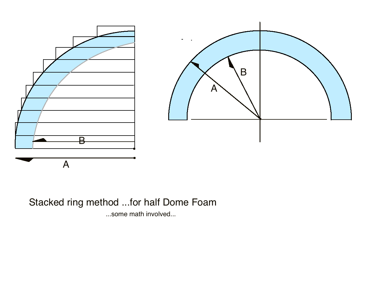

Postby GPW » Sat Mar 29, 2014 9:03 am
Couldn’t help myself but to make another self-explanatory drawing ... re: the dome roof thing ... Although I used a more Primitive (eyeball-TLAR ) method on the FS , I’d certainly use this method next time ... Much easier (save the math) and more accurate ... Easy to translate to thicker foams too ...just more math :duh:
Re: Bullet Tear
Postby lthomas987 » Sat Mar 29, 2014 10:53 am
GPW... I think you just got calculus in my trailer building. Not as good as getting peanut butter in my chocolate.
Actually that would work great. And using techniques for making stacked wooden bowls you could probably cut way down on material waste and removal.
