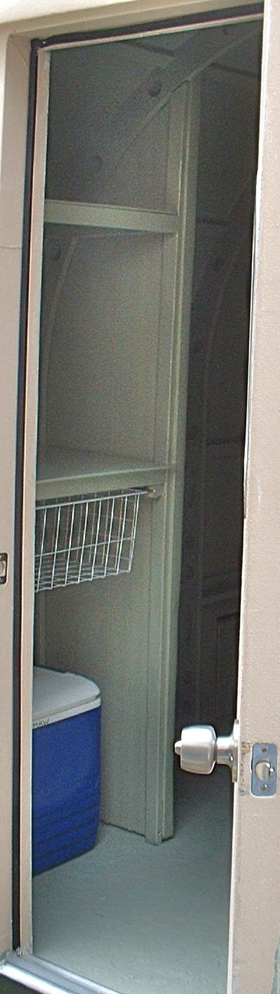

BTW, The Mini Galley has TWO (2) shelves , a slide out wire basket of good size and room for a large cooler or two small coolers ... Ample for preparation of Coffee and toast , perhaps warm a sandwich in my small toaster oven ... It ain’t the Ritz !!! :lol:
