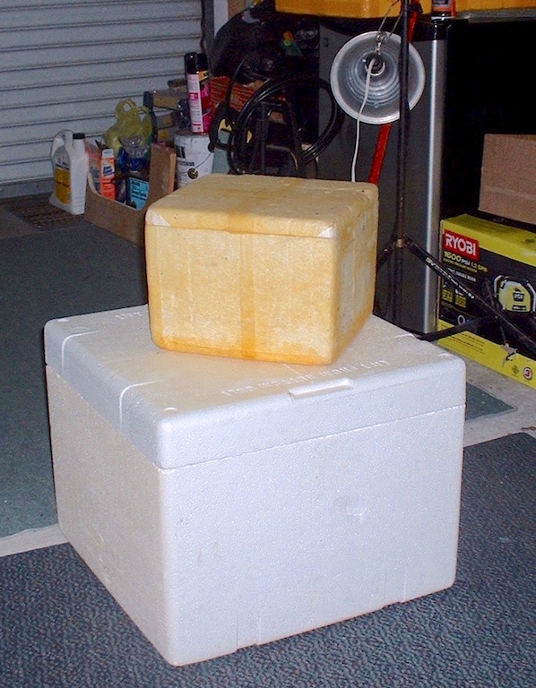

We’ve all seen those really Expensive Super Coolers , that are supposed to be bear proof and keep ice for weeks ... Well I don’t need that ( No Bears ) ...And not for several hundred dollars ... I’m Not out to impress anybody with my Beer cooler ... :roll:
Aside from the handles and latches and roto moulded ( NBD ) plastic outers , the only real thing of importance is the amount of foam insulation that’s present . That’s what keeps the drinks Cold !!! Nothing else . And Being diligent Foamlings’ we know Foam (insulation ) is CHEAP ... so we can only assume at this point we could pop together a Super Foamie cooler of our own ... And for a pittance ... Something that will keep the drinks cold for many days ... :thinking:

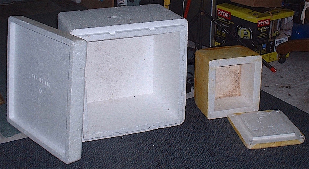

We first found a Foam box a while back ( 11” X 12” X 9”H ) and covered it with a bits of very thin fabric we had laying around ... Just that bit made a Much stronger exterior , and that was really Nothing as we could have used a heavier fabric or several layers of fabric for an extremely strong dense exterior shell ... The box has a wall thickness of 1.5” Respectable , as most “coolers” have less... But it’s too small to hold more than a couple brewskis ... :frightened:
And then we found a Bigger box ... ( 21” X 21” X 18” H ) :D With 2” thick walls , and enough room on the inside to easily add another 2" of Foam (Thinking recycling those scraps from the last build) ... Plus the addition of an Aluminum foil radiant barrier between the foam layers ... :o And still have enough room left over for a a “case" and lots of ice , although we’re thinking Block ice would last longer than cubes... (thermal density) ... Here’s the pics , it ain’t a Yeti... All it is is a Foamie cooler ... No bragging rights other than we recycled it , finished it , and it will keep beer cold for a month :beer: :roll: ( "every good story deserves embellishment! “ - Gandalf ) :R :lol:
We’re looking for a nice heavy ( and inexpensive) Plaid material for the outside ... a “Scotsman’s “ cooler ... Thrifty aye !!! :thumbsup: 8)
Could we just go buy a Yeti Cooler , why sure we could.... But that wouldn’t be any Fun eh ??? :beer:
