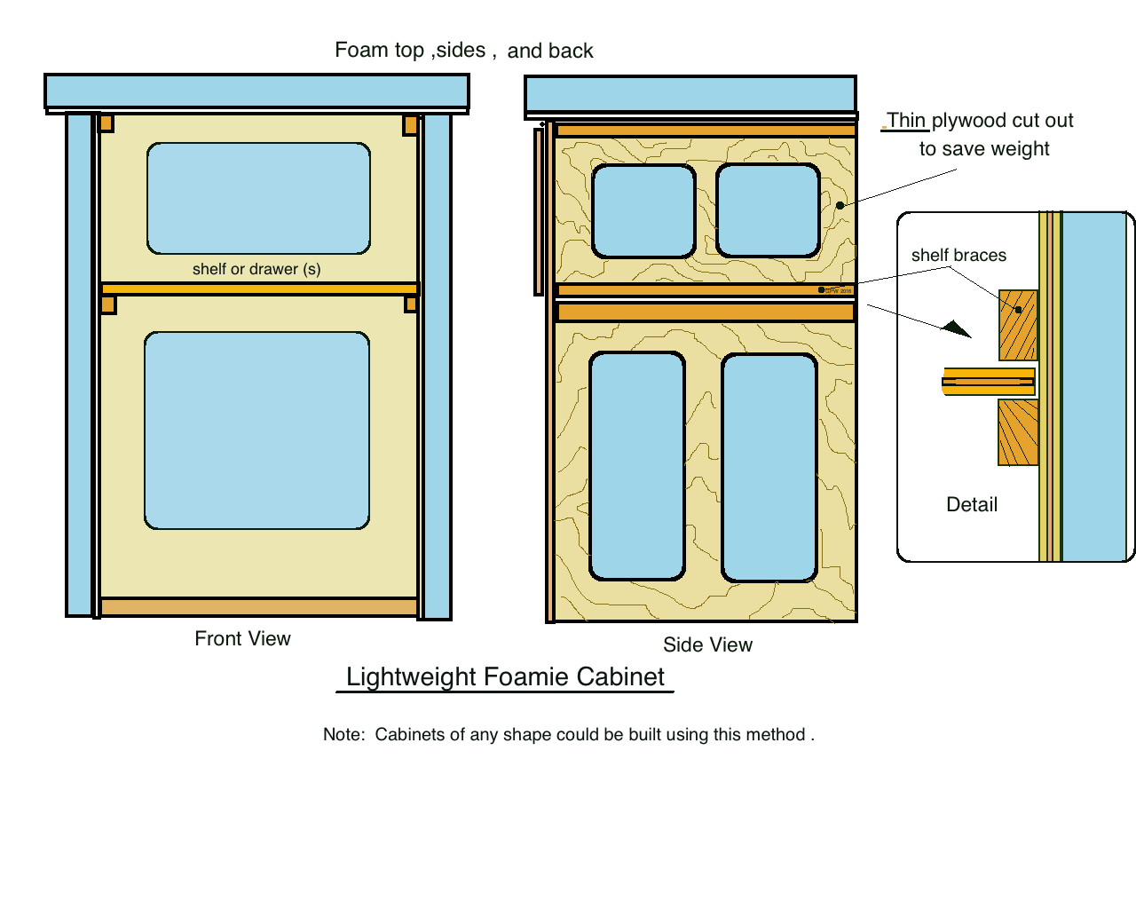

And here’s yet another drawing of a cabinet idea , Strong , but light ... :thinking: It would also be possible to scribe the sides to the cabin wall ,gluing those directly , eliminating the need for a back , and tying it in with the basic camper body ... done in the right places , it could be extremely strong ...

Postby greygoos » Sat Nov 05, 2016 7:49 pm
I did use wallpaper in my build on the interior. I tried at first using wallpaper glue over foam but it didn't go so well. I wound up priming with Gripper and it was fine. BTW i purchased at Lowes 14.00 for a double roll. From what i understand they are clearing out their wallpaper so it might be even cheaper now.
