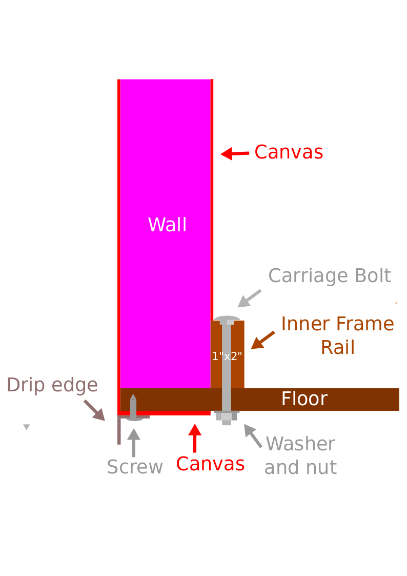

Postby GPW » Wed Apr 06, 2022 5:48 am
You know those attachment drawings were from 2010 , and while that works , since then we've learned a lot , but now we're recommending the sides end with a drip edge instead of the canvas wrapping around under the floor . In my circumstance , the constant morning dew kept the under the floor canvas damp all the time and despite much waterproofing , the canvas eventually rotted taking the old floor edges with it ... :shock:
Now we recommend a "drip edge" on all foamies , which let the dew / water go straight down past the floor level and direct to the ground. It was George that came up with a workable drip edge using commonly available ( and thrifty) sheetrock corner edging ... It was what I used after replacing my floor with a new "board floor:" , and that has been absolutely no problem since ..
IMHO , something like this works better ... :thinking: 156655

Postby BrianInVA » Wed Apr 06, 2022 8:04 am
I understand what you’re saying about a drip edge.
However, in the colored portion of this drawing, I don’t understand how the wall is supported, if it doesn’t rest directly on the floor, as in the un colored line drawing in the same image.
What suspends your wall in the colored part? My floor is even with my wood frame so I’m not sure how I would do this.

Because my floor and wooden frame extends beyond the metal frame on the front, back and sides of my utility trailer, I was planning on just wrapping the canvas from the pmf on the exterior of the wall down and under the wooden frame, gluing it then securing it with pvc quarter round trim, which would also serve as a drip edge under the frame.
Think that would suffice?

Postby GPW » Thu Apr 07, 2022 3:25 am
Now then , I have an inner framework to support the walls , so no problem ...But no matter how you choose to attach your wall, a drip edge is Very important ... JMHO :thinking: Water is the enemy of most every trailer . :frightened:
One idea should we choose to wrap the canvas under the trailer , before you paint it , coat it liberally with the Mix , we know that works ... :thumbsup:

Re: Searching for an image of wall to floor attachment
Postby GPW » Fri Apr 08, 2022 5:36 am
We've had No problems with the plastic corner edging , been years now ... works just fine !!! :thumbsup:

Postby ghcoe » Fri Apr 08, 2022 9:22 pm
I lost all my drawings when I had a hard drive fail on me. These are drawings I have drawn up to try to explain the theory recently. I don't have as much time as I did to make them perfect, but it should get the idea across.
#1
Inner Frame Rail and PMF explanined.png (36.23 KiB) Viewed 718 times
#2
Canvas wrap and drip edge explained.png (43.88 KiB) Viewed 718 times
George.

Postby BrianInVA » Fri Apr 08, 2022 11:57 pm
ghcoe wrote:I lost all my drawings when I had a hard drive fail on me. These are drawings I have drawn up to try to explain the theory recently. I don't have as much time as I did to make them perfect, but it should get the idea across.
Excellent, thanks George!

Postby GPW » Sat Apr 09, 2022 7:04 am
Yes, Thanks George!!! I used your drip edge idea and have had No trouble since... much appreciated !!! :thumbsup:
