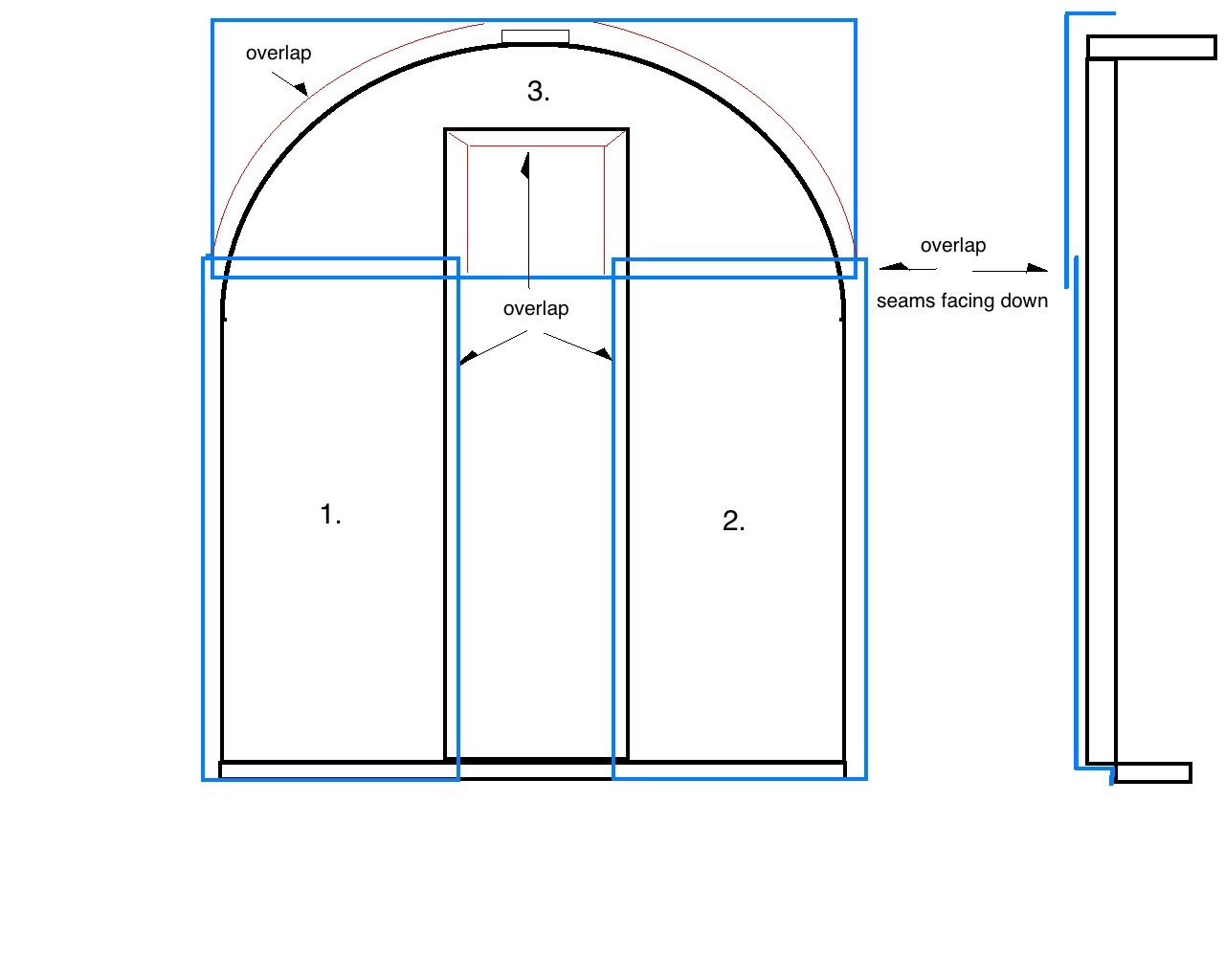

Another drawing ... :roll: ... The rear covering plan ... Can’t cover it in one piece ... the canvas is only 60” wide ... so it’s piece work ...

Postby KCStudly » Thu Jul 04, 2013 7:15 am
Suggestion. Sort of echoing back your own advice. The little inside corner under neath the bottom lip; you may want to think about doing that first with a thin strip, then the main vertical sheets can just wrap around the outside corner and will tend to lift less.

That’s a good point !!! Will do that !!! :thumbsup:

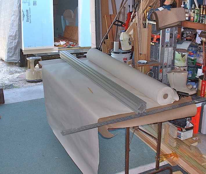

I’d just like to mention the many benefits of a CLEAN work surface to cut the canvas parts out on ... the Bigger the better ... You don’t want to roll out clean canvas on a dirty surface , otherwise all the little bits will stick to the canvas (naturally ) and “telegraph” through the canvas and paint finish ..... grrrrrrrrrrr!!!

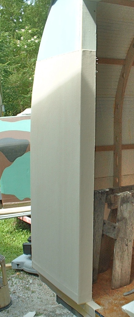

Postby GPW » Thu Jul 04, 2013 9:40 am

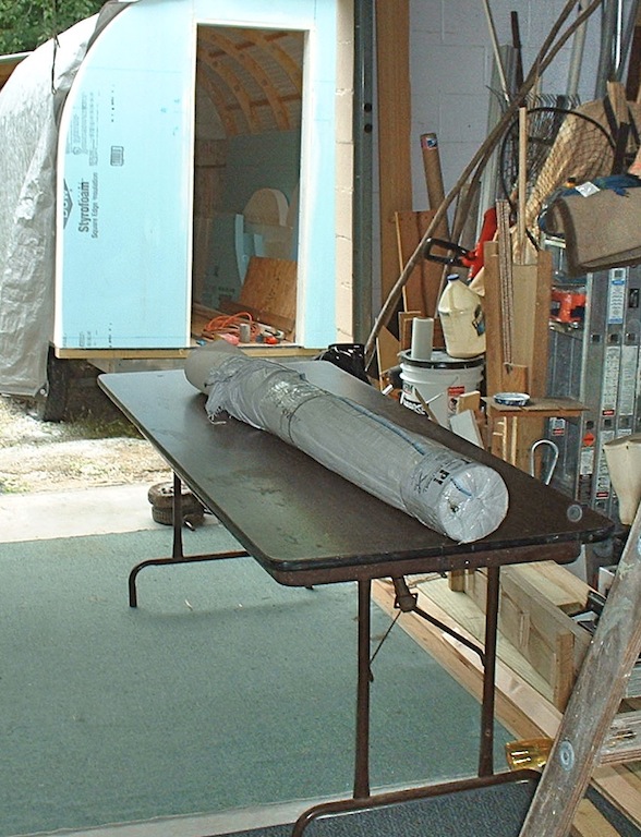

OK... Initial measurements made and drawn on the rear (Sharpie) , all surfaces sanded and brushed down to remove any remaining particles ... Actually vacuuming is not a bad idea either !!! First the strip on the bottom (Thanks KC!!! ) then the larger piece. I did “soften" the door frame edges slightly (hand plane /sandpaper) to lessen the strain on the fabric across the sharp corner surface ... Some Al trim moulding might be Nice on these edges... later ... :thinking:
And a pic of the cutting table , which is just about to get a nice kraft paper top taped on ... keeping it very CLEAN ... ;)
I have to be particularly careful of the Gazillion (literally! ) little foam dust bits and beads...which seem all too ready to jump on a nice clean piece of fabric... so can’t get the fabric , near the ground , furniture , or even myself .. :frightened:

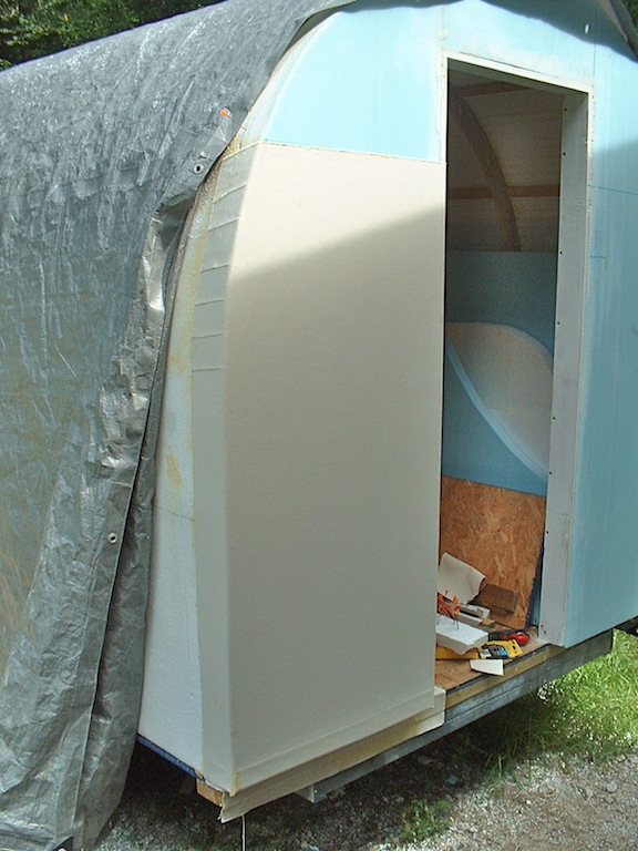

Postby GPW » Thu Jul 04, 2013 10:57 am

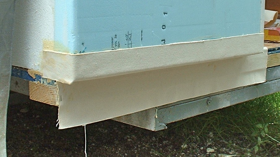

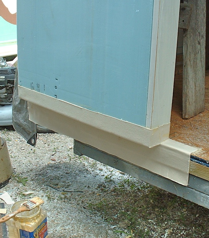

Added the KC strip ... :thumbsup: Then painted the T2 straight onto the foam and attached the second big layer over that ... The very bottom is yet to be trimmed...
