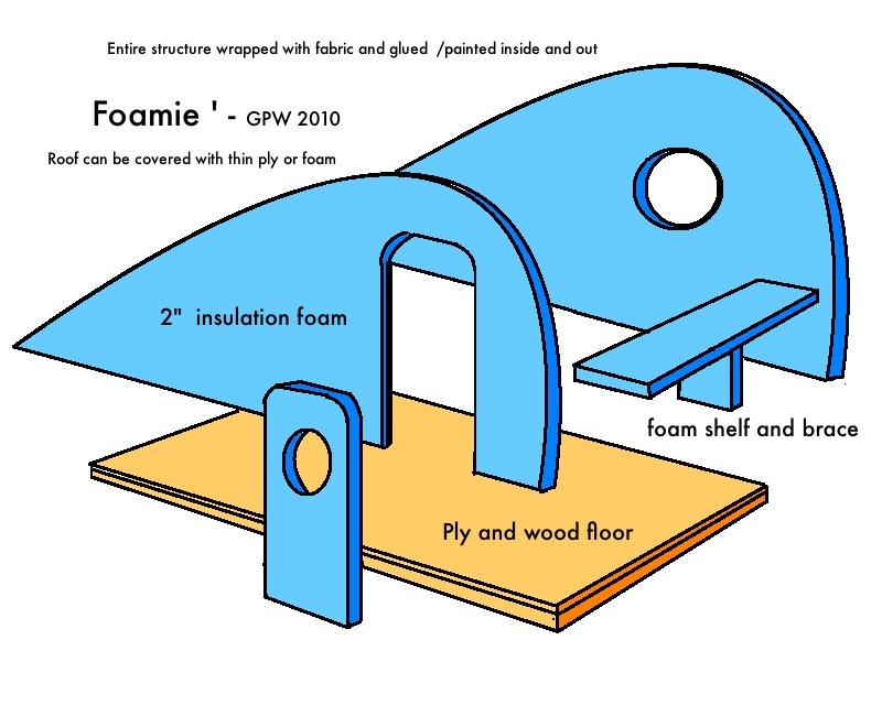

You know my thoughts (FWIW) was to build/glue the whole trailer shell out of Foam pieces/panels, sand/round everything nicely , and then cover the whole assembly (much as I would build a fuselage ) inside and out with fabric .. then paint it ! You'd have to add all your hard points/ bracing (?) in before you cover it , although for an "additional" attachment , you could easily cut through the outer fabric and route the foam for an insert , then just cover over it again ... and you can use a "pinked' edge on the spot covering fabric for a neater aircraft look .. 8)

The thinking , so far, is to glue the sides , front back walls to the floor ( Plywood ) and then wrapping the fabric around and under the floor slightly , (inside and out) , anchoring the shell to the floor , which is bolted to the trailer frame ... perhaps a double layer of fabric (extra strip) for those who are cautious ...

i am with you on the 2". had that in my head. in my sketch up i have alotted 3" for the sides. so 2" for foam and then the fabric. i have another 1 for the fabric, i am sure i will not be using that much, so left overs will just be that much more room inside.
thanks for reinforcing my thinking that foam to foam wouldn't be good with t2.
i must not have understood what you were trying to say. i see what you are looking for now. the whole thing wrapped to under floor. yeah i wasn't looking at it like that. i had only thought of doing individual pieces then just using them like single pieces of wood and attaching.
still too early in the morning for me, but i am liking what i am seeing in my head. i like the total wrap idea.

Eagle , the total wrap would tie everything together , like a sock (sorta').... and the idea of extra reinforcement fabric around the supposedly high stressed areas seems judicious .. With a heavier fabric (than a sheet) like canvas or fiberglass , it should be Very Sturdy... especially after being painted with a latex paint , which after about a week or so dries very hard ... Unibody construction ... works on cars ... :roll:

Couldn't help myself ... just had to make another drawing ... Image
Postby eaglesdare » Mon Nov 15, 2010 1:29 pm
:applause: you know i love it.
my neighbor is giving me his boat trailer. we are going to make some mods on that and then my fun starts. (of course i don't know when he will give it up, i am trying to push him now though).
but so far i am assuming you are using one standard size of foam board for he walls. 4x8?
what if you wanted taller? like a 5' in height? or even wanted larger than 4x8, like 5x8? or any other size that would require more than 1 single piece? do you think that would still work?

Foam being a homogenous material can easily be glued together for larger sizes ... The glue will be stronger than the foam , so no worries ... especially after the fabric is attached ... :thumbsup:
For much larger TDs , you could always glue in a foam arch across the inside ceiling/walls for extra strength , like I did in my 6X12 TD ... much strength added , and it's "decorative "... ;)
