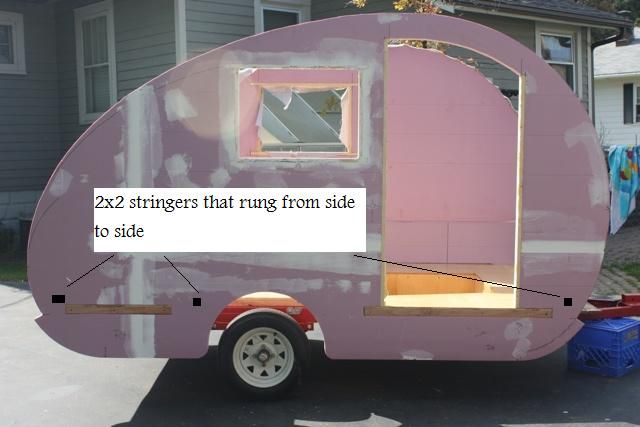

i was thinking about adding some 2x2 that run across the top of the floor
or in the rear it could run as part of the bunk set up from outside wall to outside wall
possibly do this in any front bracing that i may come up with
do you guys think this may be a bit of overkill as i know the spars and the top foam will help tie it together

are you going to have a galley? if so, you will have a wall in the back that runs side to side. so i don't see a need for them in the back. and well i don't see the need either for the front. i don't have them in mine. unless i missed something that you needed them for. :wine:
