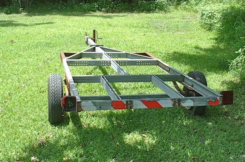

Update. Before the heat got to me, I was painting the frame. Not much left, but I'll have to wait until this evening.

There's a lot more nooks and crannies than you would think. Just part of the back, the tongue and the bottom left. Whew!

Postby GPW » Mon Jul 18, 2016 4:47 pm
Best check those welds Bonnie .... :o
Re: Nookery Updates -- New frame and floor June 2016
Postby bonnie » Mon Jul 18, 2016 7:21 pm
Have no idea what to look for. There's no cracks or gaps though. The added part is bolted on.

Postby bonnie » Mon Jul 18, 2016 7:22 pm
With 6 bolts

Postby GPW » Tue Jul 19, 2016 6:17 am
My good friend ( car mechanic) and I personally assembled the Trailer in my Studio , so I’m sure it was correctly assembled ... But we “assumed” :o the welding was done right .... :NC If you know a good welder , it may be worth it for him ( or her) to just have a look at it to see if the welds are sufficient ( inspection) ... :thinking: It appears Mike’s trailer might have gotten one of those Friday afternoon , I’m getting off work in ten minutes , welding jobs ( quickee) ... :frightened:
You my not know , Chinese factories impose strict production quotas on their workers , and if they don’t fulfill those quotas, they have to stay after work and finish on their own time ... ( unpaid) .. This may lead to less than perfect work being done in a hurry ... :roll:

I will look into it, but the trailer is bolted and welded everywhere it might break. I'll be taking time to inspect it, but I'm confident it will hold together.

Postby GPW » Tue Jul 19, 2016 6:50 am
Yes , please do have a look .... we KNOW the bolts were done right ... the welds , we dunno'... :NC
The FoamStream trailer was made by the guy in my Band who lives right down the street ... He and his son are both very experienced welders .. so I know that’s done right ... 8) :thumbsup: It’s ALL welded ... :thumbsup:

With this being a brand new trailer, I have every expectation the welds and bolts will hold up. The young man who welded the additions, new cross pieces, and all the tongue joins and such is very experienced. Now that it's painted and ready for the floor. I'm pretty stoked. I will watch the frame for failures, but I think I'm set.
