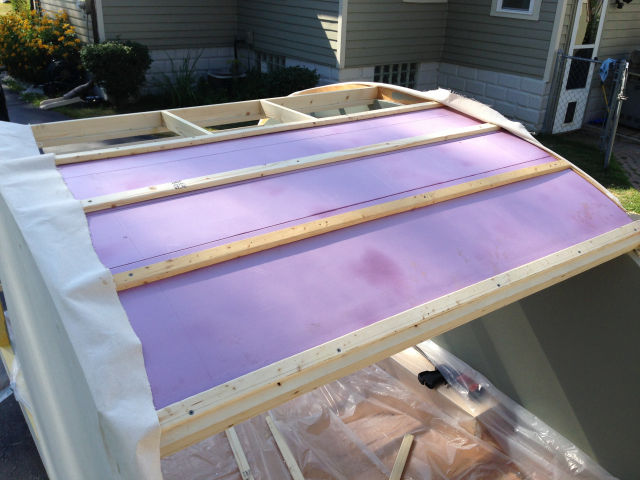

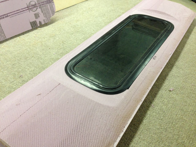

Here's the panel for the window, still need to glue in a center section of 1/4" plywood, but you get the idea...

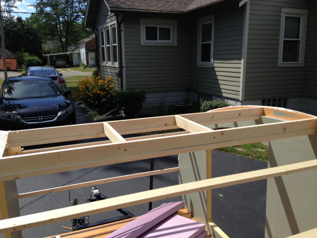

I glued in some framing for the roof vent. Still have to add the little pieces in the middle, so that I have 1 1/2" of framing to mount to.
Also tried gluing in the first roof panel without kerfing. It felt pretty stressed out, so I took a heat gun to it. I'll know tomorrow if that made a difference.
What you see on top is just some clamping boards, those will come off tomorrow.

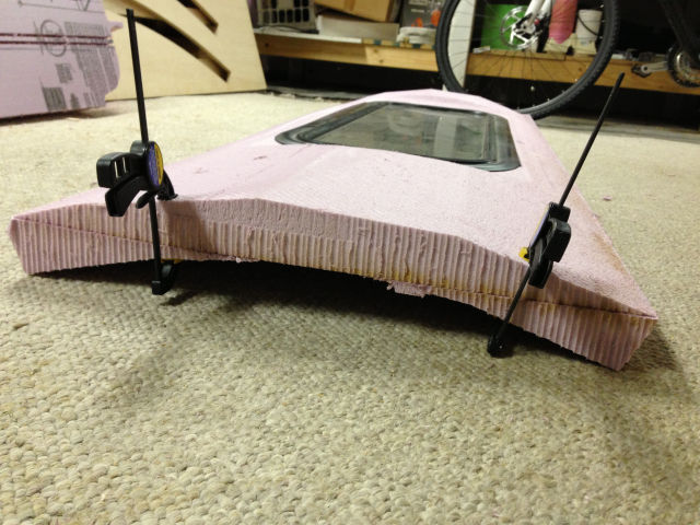

Here's an end view of the window panel that shows where the parting line is...

I've made one very big error though. The galley spar, the one that the hatch hinge mounts to is only glued to the foam, not the hardwood edges. When I glued the roof panel on this afternoon, the joint broke. I currently have it sitting in a pool of gorilla glue, with a pipe clamp on it. I'll know tomorrow if that's still going to be an issue. If so, I'll have to perform major surgery, and extend the hatch spar down to the hard edge. :frightened:

That window panel looks terrific. :thumbsup: Should be strong too as a multilayer composite panel.
You planning on a cover for the window, assuming that goes on the leading edge of the TD like it appears ?

It's really not that fancy! Anyways, the foam is really soft now that I've whittled half of it away. I'm hoping the gluing it up to the plywood strengthens it up again. The first half is in the garage drying. I'll glue up the second half tomorrow, and then I'll try to get a picture.

No window cover planned as it's going to be on an angle. Of course, that could always change!!!
