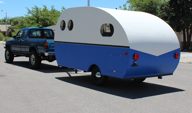

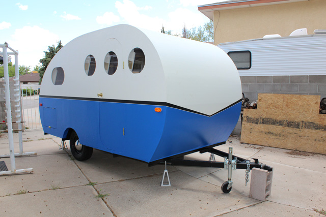

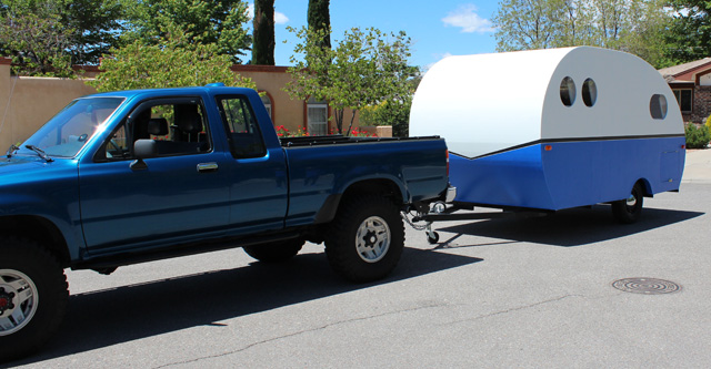

Postby NMMarauder » Sun May 10, 2015 10:28 pm
More progress....

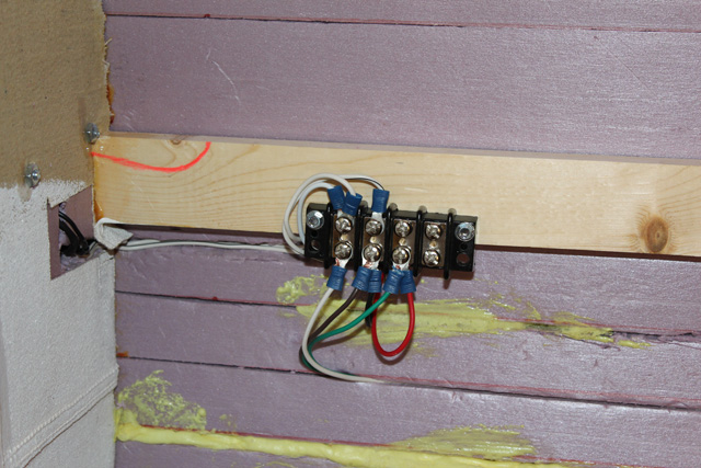

I installed the tail and clearance lights and ran all the wires inside the the flexible conduit which is attached to the frame up to the tongue. I either used crimp connectors or solder with heat shrink tubing for all connections with the exception of a couple of terminal blocks. Since all my lights are LED, it is unlikely that they will fail in the lifetime of the trailer but I still wanted to make it easy to replace one of the fixtures if needed, thus the terminal blocks are there to make it easy to change out a fixture. Shown below is the terminal block that connects the tail and side marker light with the rest of the wiring. This bock will be under the bed platform so I didn't worry about trying to hide it since the bed will hide it. I'll unhook it when I need to canvas that section of the wall.
I also slid the trailer out of my garage and put the wheels on. Here it is with its tow vehicle. Now that it is out in the sunlight, I can see that I will need to go a bit darker with the blue if I want to get a better match with the truck.
It's not actually hitched to the truck at this point because I was measuring what size drop hitch I will need to purchase since my TV sits fairly high. I did take it for a spin around the block and the truck doesn't even know it is back there. I wouldn't expect it to since my best guess on the current weight of the trailer is 680 lbs. Of course it is just a shell at this point so it will get heavier as I finish the interior.
I still need to paint the black stripe on the rear of the trailer. I didn't paint it initially because I wanted to see what it looked like with and without and I like it much better with. I also really like the tail lights. I need to get an evening shot because they look very good when they are on. They have this cool center ring of light. If you look closely you can see the 2 receiver hitches that I welded to the frame on the rear of the trailer. My thought was to use those to mount a tire rack, bike rack or even bumper. Not sure what I want to do with them yet but they are there and ready for use.
One more shot of it sitting beside the house.
At this point I could camp in it. It is like having a hard sided tent on wheels with a door and windows. I don't know if my trailer counts as a "Tiny" travel trailer. I guess compared to the monsters on the road today it is pretty small but I don't know if I qualify for "Tiny".

Postby NMMarauder » Mon May 11, 2015 9:14 pm
OP827 wrote:... Sooo, you'll be glueing canvas inside too?
I have enough left over canvas, glue and paint so it would be the thrifty option. I looked at the big box stores for some sort of thin panel that I could use but nothing caught my eye. The walls already have canvas so it would provide continuity if the ceiling did too. If anyone has better ideas, I'm all ears.

Re: New Build: A canned ham in foam
Postby NMMarauder » Mon May 11, 2015 9:18 pm
Ned B wrote:That's one handsome trailer!! unless you're going for an exact match, I'd leave the paint as is. It is 'in the family' and looks great!
Thank you for saying that. I knew I couldn't get an exact match unless I was willing to have it sprayed with the same automotive paint. It came down to 2 Behr colors; Electric Blue and Planetarium. The electric blue looked nicer on its own than the darker planetarium so I decided to go with it. The nice thing about using a good quality exterior latex paint is I could grab a brush and roller and change the whole paint scheme in a day.
