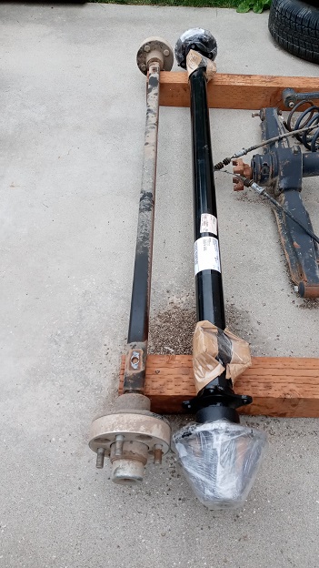

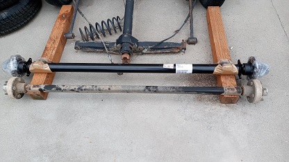

Shortly after installing the soft ride spring kit, I noticed some tire wear. Not related to the spring kit but I bent the axle or a spindle on the trail someplace. It was bound to happen, and I am surprised it took that long before I had a issue.
I ordered a 3500lbs axle from Compact Camping Concepts https://compactcampingstore.com/product ... 0-lb-axles . They will make them to the specs you need. You can see the big difference in the two axles.
Axles
20220619_092859 s.jpg (305.48 KiB) Viewed 2666 times
Axles 2
20220619_092907 s.jpg (358.3 KiB) Viewed 2666 times

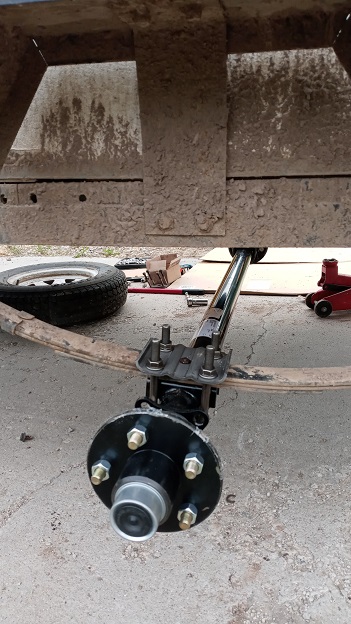

Piece of cake to install. Unbolt old axle and bolt in new axle.
Installed
20220619_095454 s.jpg (361.15 KiB) Viewed 2666 times

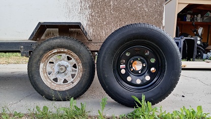

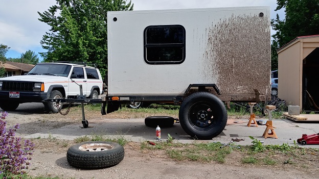

I gained quite a bit of lift with the axle swap. The new axle is a bigger diameter and had a spring perch on it which gave me about a 3" gain on lift at the hub. I had ordered the new axle with 5 lug hubs, so it was time to finally move to a 15" trailer wheel/tire.
tire comparison
20220619_085634_HDR s.jpg (316.98 KiB) Viewed 2679 times
This gave me even more lift!

I don't think I will be bending any axles with this set up.

Kind of why I started out with the big axle, I guess. Looks like you will need much larger fenders for sure now.

KCStudly wrote:Kind of why I started out with the big axle, I guess. Looks like you will need much larger fenders for sure now.
They look a bit small, but I have been running them for quite a few trips now. Probably will get something bigger someday.

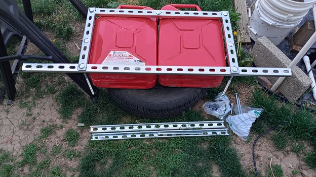

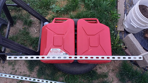

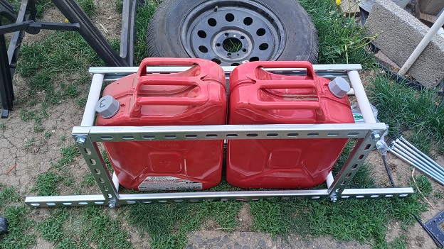

My next foamie accessory is a tongue rack. Basically a rack to hold two Jerry cans and a spare tire for the trailer and also act as a stone guard. I used unistrut, pcv pipe and carriage bolts for the frame. Worked out pretty good.

George.

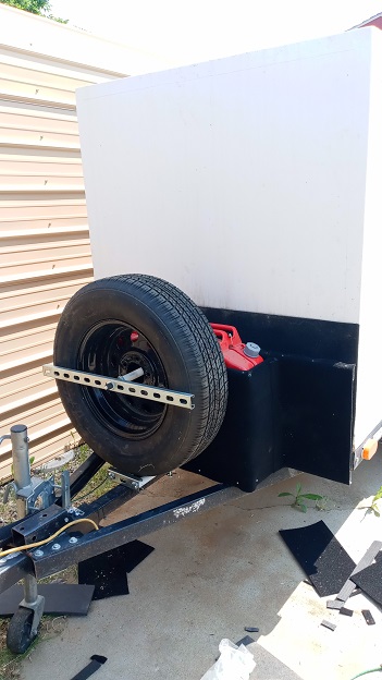

Once I got the frame built, I bolted it to the trailer tongue. I used self-tapping screws to screw on some indoor/outdoor carpeting to the frame. This made the rack look better and also acts as a stone guard for the trailer and Jerry cans.

Is the PVC just to protect the plastic jugs from rubbing on threaded rod? Hoping you used nuts on the inside to jam the strut onto the threaded rod, making the rod the thing that takes any loads and not the PVC. Just saying, the PVC doesn't take structural loads well, especially not impacts which tend to shatter it, even more so when exposed to UV light over time.
I'd be interested to see how you keep the jugs from bouncing up; is there a hold down or bungie cord feature?
Again, that looks like a good fit for your rig. :thumbsup:
The PVC pipe is a spacer and anti rub against the thread on the carriage bolts in some places. I used washers on the inside channel where the PVC comes up against the unistrut. There is not much pressure on the PVC just enough to make it snug. The carpet is wrapped around the PVC pipe so none of the PVC is exposed to UV light.
No hold down or bungie, just gravity. The pockets are pretty deep so I would doubt that they could ever come out of there. A extra bonus is that the fit is pretty tight and when the tanks expand you have to let the air out of the cans to get them out of the pocket.
