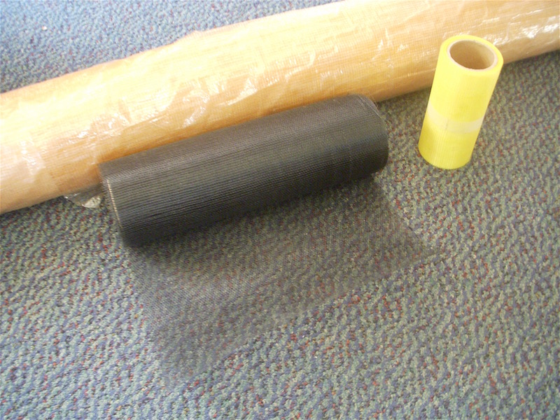

I'm pretty sure when GPW says he used fiberglass tape, he is referring to drywall joint tape with a very open mesh, as opposed to laminating glass cloth in strip form.
Re: A more durable Foamie?
Postby gizmotron » Wed Mar 15, 2017 1:33 pm
Guess I should go to home depot and look to see if that yellow stuff is really fiberglass. It looks like plastic.

Er, No, actually it was the heavier 8” wide cloth formed into a tape , from the Boat shop... not expensive ,thick, very strong ... I use the drywall fiberglass for my RC Foamie models , we also have a Kevlar and carbon fiber weaves too ... but that gets expensive ... and difficult to apply , glue and sand /finish ... as you know ... :roll: We’ve got lots of the exotic stuff in the shop, just the common stuff we keep running out of ...
