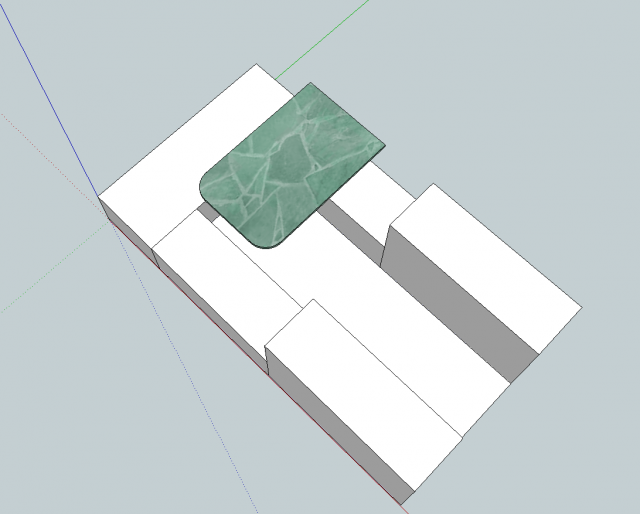

I don't know if such plan idea was ever discussed, it just appeared to me if the table top is turned 90 degrees for dinette, day position then it creates more space inside compact design trailer. Then the dinette becomes easier accesible, provides 1-2 feet more space in the kitchen area to move around, it's kind of an L-shape. See the sketchup snapshot below. What do you all think? Dimensions are similar to Compact3 trailer floor plan.

Here’s an idea (no drawing needed ) make the trailer empty , make the furniture/cabinets ... put the furniture /cabinets in the TD ( unattached ) and move them around to see how it “feels” with different configurations .. ? Find something you like , Glue it in !!! ;)

I'm thinking about limiting the trailer to 10' long. I would let 4 or 5 feet or so hang out over the back end of the trailer, and that would be where the bed would have to go. Think about the back end of a T@B, something similar to that.
The I could let a foot or two hang out over the front of the trailer.
Then all the furniture could be re-arranged except for the bed.
And depending on what ended up being the best floor pattern, I can only hope that the door is in the right place!

Mike, what is your plan for stabilizing jacks placement and how will they provide good stability with the bed in the back?

That potty ??? Will be "fun" to cut a compound curve to match the wall and roof ... :o Why not just use a curtain and jam that small potty up in the corner, maybe with a cover that would function as a seat or small table ( slide out potty ? ) ... With that you could turn the diner 90 degrees and lose some of the excess trailer length ...

GPW wrote:That potty ??? Will be "fun" to cut a compound curve to match the wall and roof ... :o Why not just use a curtain and jam that small potty up in the corner, maybe with a cover that would function as a seat or small table ( slide out potty ? ) ... With that you could turn the diner 90 degrees and lose some of the excess trailer length ...
Yes Mike, I know you said that this is very preliminary, but are you going to optimize the floor plan length at some point too or you like it being longer like that? What I am trying to ask is: have you decided on sleeping, sitting, potty etc. requirements, like what will be the scope for this trailer project, or it is not decided at this point.

Postby mikeschn » Wed Apr 19, 2017 3:51 pm
OP827,
Ah, the scope! As this project is in it's infancy, and I have almost a year to figure out stuff, things are wide open.
The starting point is:
What can we live in for 6 weeks?
What is really light to tow?
It's gotta have a porta potty.
The wife likes to have a TV
I like to have a place to set up the laptop
And we have to be able to cook inside in case of rain
2 mini schnauzers can navigate the interior without getting hurt
I could cheat and get a Casita, but what's the fun in that?
As to your eariler question regarding stablizers, the plan has always been to have 4. I didn't look real close but I'm guessing I can add a couple BAL stabilizers across one of the under bed spars. I would have to make the spar a 2x4 rather than a 1x2. That was a really good question! Keep em coming!
