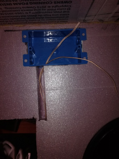

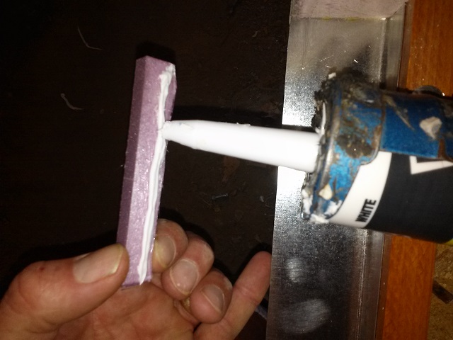

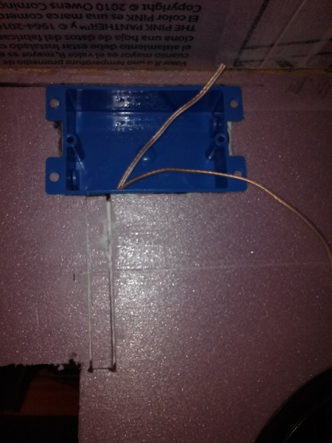

A couple of tips.
When cutting out for the PVC pipe I used a hot wire to make the cutouts. Once you have the cutouts you can cut back the depth of the PVC/wire and then reinstall the foam over the PVC. Included photos for example.
Cut
Glue
Reinstall
Once dry add a bit of spackle and then sand flush.
Great Stuff and Gorilla Glue is a lot harder to sand than the surrounding XPS foam. In my case I took a dremel tool with a grinding bit and ground the GS/GG below the surface I wanted to make flush just a bit. Then I filled the void with spackle and once dry sanded it flush.

Postby amandacreiglow » Sat Oct 14, 2017 2:23 pm
ghcoe wrote:A couple of tips.
Yeah, I think the cleanliness and exactness of the hot wire rig lines makes a huge difference. One of the big things I'd do differently (and that I will do differently for the next one) is making and using those hot wire rigs like you did, as well as a larger version of a styroslicer like this guy made: https://m.youtube.com/watch?v=N2n_EbRzZ0g for the big and angled cuts. I had thought that with a project the small it wouldn't be worth the effort of figuring it that it, but in retrospect it totally would have.
I went with the pvc pipe because somehow in my mind it feels safer than having the wires directly in the foam, plus I wanted to put off figuring out the wiring, plus I wanted to make it possible to pull and re-run the wires easily in the future. But I'm fairly certain that the idea it's safer is all in my head, and when I figure out the wiring shouldn't really make a difference in my design plan, and with the difficulty threading the wires through through the right angles on the front, rewiring would be a bit of a pain anyway, if I needed to.
All that to say that, your method looks really nice. I will say, though, that the spackling and great stuff fill in around the pipes on the interior actually ended up a lot smoother than I thought it would. The lettering on the foam showing through was a much bigger problem and much more noticeable than any unevenness from the great stuff and spackle, so if that doesn't change with temperature, the final result might not end up that different...
