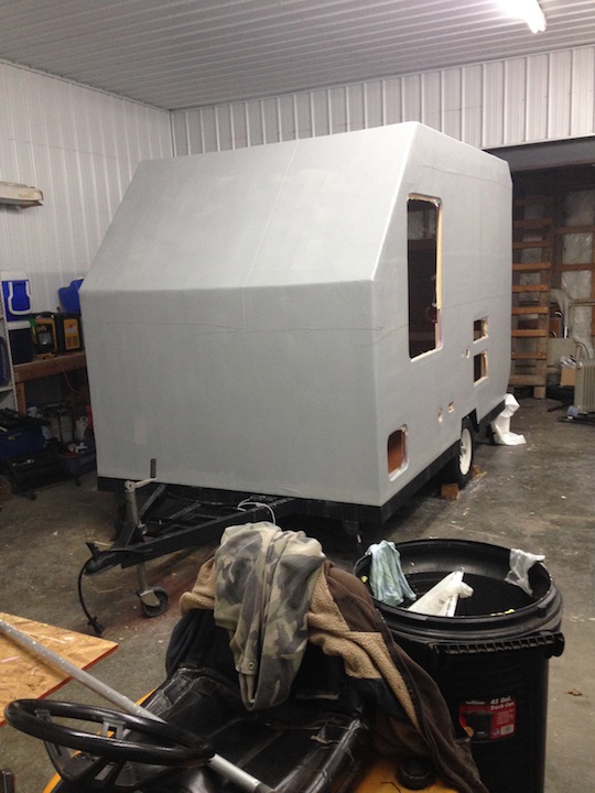

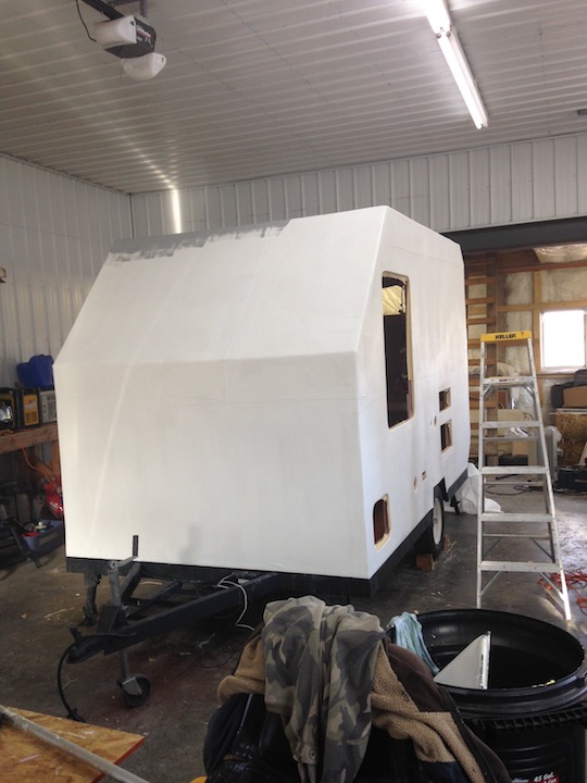

So I did get started painting a little after lunch time. 1 coat of primer. 2 coats of paint. The first pic is primer (with a little paint on the upper left corner showing from the roof. Second pic is after two coats of paint. The second coat of paint was sheeming pretty good. I think we're getting there. Its still going to get at least one more coat of paint, probably two more. Then a blue stripe over the Cosmic Quest Grey base color.
My wife and I like it. Painting is always fun. Makes a project start to look finished. Way better looking than "dried glue yellow" color under the paint

Re: A Tiny Travel Trailer for a Family of Four
Postby GPW » Sat Apr 28, 2018 5:46 am
Bru, after a hurricane we had a large water Oak fall on my house , I got the local "tree man" to remove it , they charged me $10K only because they knew the Homeowners insurance would pay for it … They did a great job and did no harm to the house , But they really took advantage of us to make a quick buck (s) … There’s a LOT of that going on here… Just plain GREED … I think that was the only thing to “trickle down” from the “economy” … :R
Glad you found someone reasonable … a “good neighbor” :thumbsup:
2 coats of latex + primer should be plenty … too many layers of paint can crack later … And remember latex can take a couple weeks to completely dry and cure … You’re doing GREAT !!! 8)
