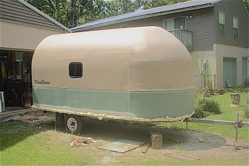

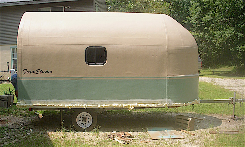

Was able to screw down the ply nose rib and then foam in all around the trailer … We’ll let this dry , trim and sand and then get out the canvas and the gripper … :thumbsup: Moving right along now … :D
Re: FoamStream , the restoration … a lesson learned .
Postby GPW » Sun Jul 29, 2018 12:34 pm
And then today we got out an ancient cheapo serrated steak knife and trimmed off all the extra dried spray foam in a very few minutes … Easy … :thumbsup:
Now there are some spots where I could use a bit of a “Filler” just to level everything out … My instincts say sheetrock mud ... not the best idea , but easy … or just another underlying layer of canvas ( The previously mentioned “reinforcing strips” ) There are bound to be some air gaps around the floor wall join , but the plan is to Gripper the holy S*** out of the Foam face and the back of the canvas as well as the front …maybe using a thinned sizing coat in between … We’re going for Durability this time , and still trying to make the repair look “decent” ;)

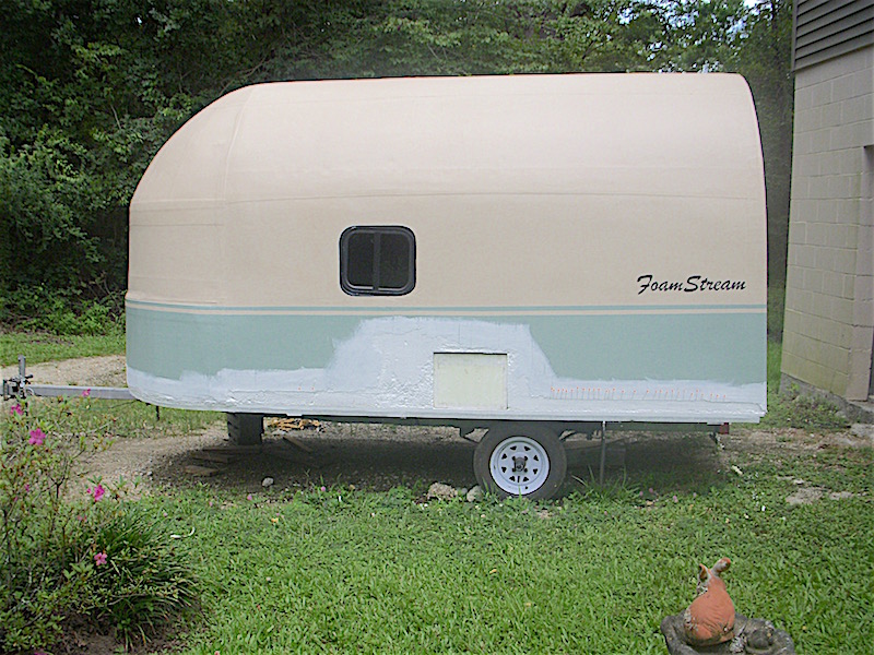

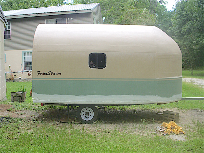

Had my paint clothes on and ready to gripper the open foam areas in preparation for canvasing …. Then it started to rain … Again !!! Nature seems to want me to drag this job out waaay longer than it should have taken … :duh: more waiting … What can I do … besides build a Barn … Image
Postby GPW » Tue Aug 07, 2018 11:20 am

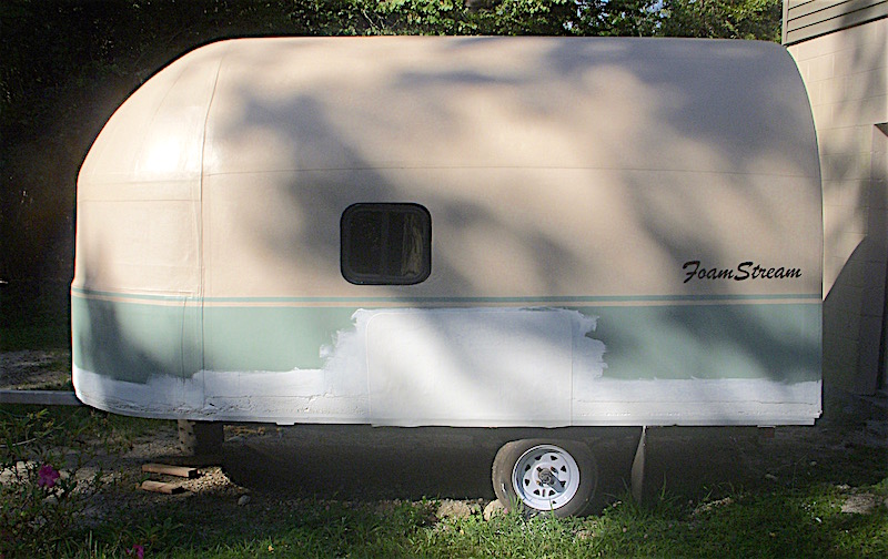

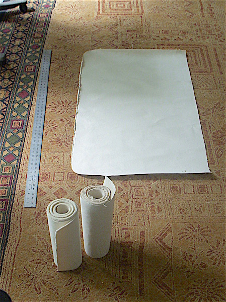

OK , we got the trailer primed where the canvas is to go , and cut out some strips and a patch for the AC side … I was asking the wife if she thought I should make the foam smoother before I canvassed it … she said “ just get the damn thing finished !!! “ … :o
Postby GPW » Tue Aug 07, 2018 11:30 am
This Foamie repair , although a radical “floorectomy" , has actually been pretty easy to do , except for the weather… If I had it inside , we’d have been finished months ago …. and no baby birds either … :R And you can see we never made much of a mess either … :D

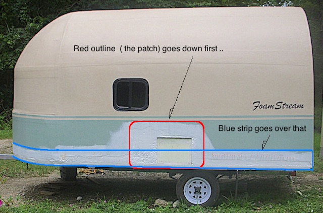

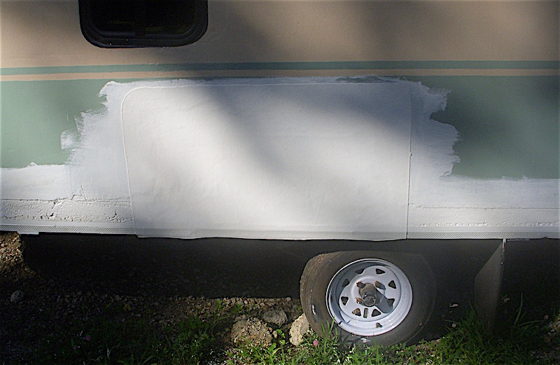

Today , we’re betting we won’t get rained on ( dice roll) and am going to replace that 24’ H X 40” W piece of canvas on the port side by the AC vent . ( a Big Patch ) The place that the visible foam surface has "acne” cause by ants tunneling under the surface . ( grrr!!! ) We have been thinking about how to cover the AC vent , which apparently is an area susceptible to water entry ( and Ants)… and so for now , we’re going to cover right over the whole thing , and if we ever need to pop in the AC , I can just make three short cuts (sides and bottom and roll up the canvas , then stick the AC in … Closing it again , I can pop in the foam filler piece and just tape the two sides with my new Friend , Gorilla Tape … :thinking: No leaks , no Ants …
Around here , any hole in the structure is a chance for a leak … :rainy: So far we’ve had the brand new AC , sitting on a dolly in my Utility room … If we need it , we got it … If we don’t, then that area stays sealed and waterproof .
The long strips 12” X 16’ will wrap all around and joining with the drywall corners , will form the requisite drip edges …
And … in order to really waterproof this this thick 18 oz. canvas, we’re going to thin the Gripper by 50% ( water) and use it as a sizing to sink down and seal all the inner fibers , then prime that with full strength Gripper , then a couple coats of colored Latex and we’re done … with the outside … Inside is a few touches , install the nose cards (chipboard , which did Fine) , paint , and find a nice rug for the new floor … Then we’re done … :D

Postby GPW » Wed Aug 08, 2018 4:50 pm
Although rain was promised by the weather service , it didn’t happen so we went ahead and installed the Big Patch … No problems with Gripper and it stuck well to the drywall corner too ( drip edge … and that’s important ! ) glad to get this part done . ;)
