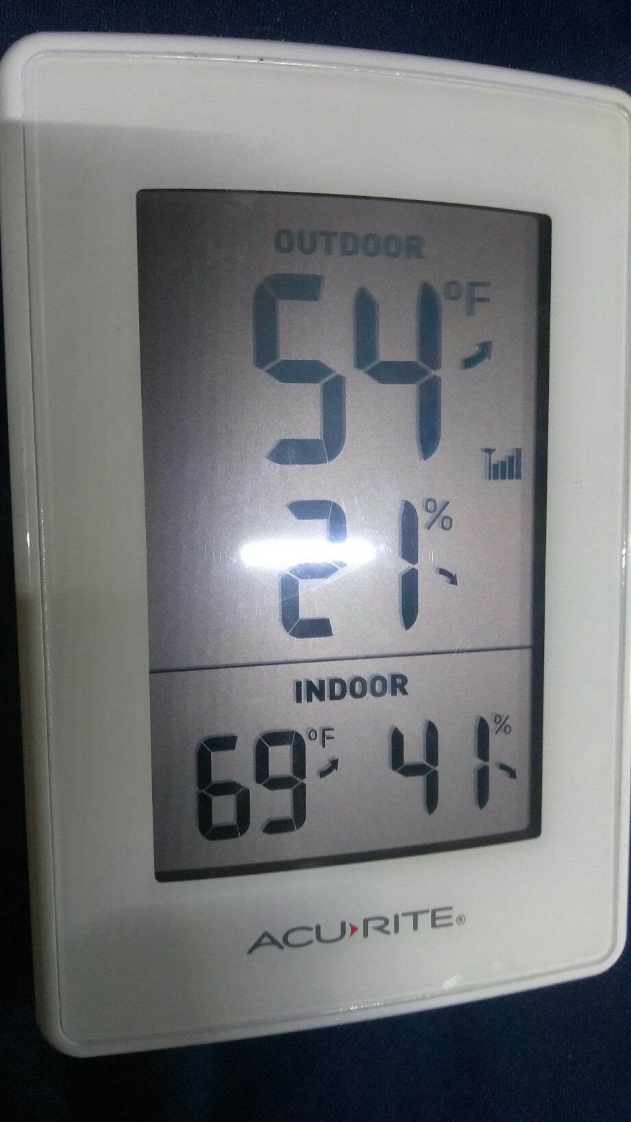

11:50am, out 54, in 69.
Getting comfortable inside now.

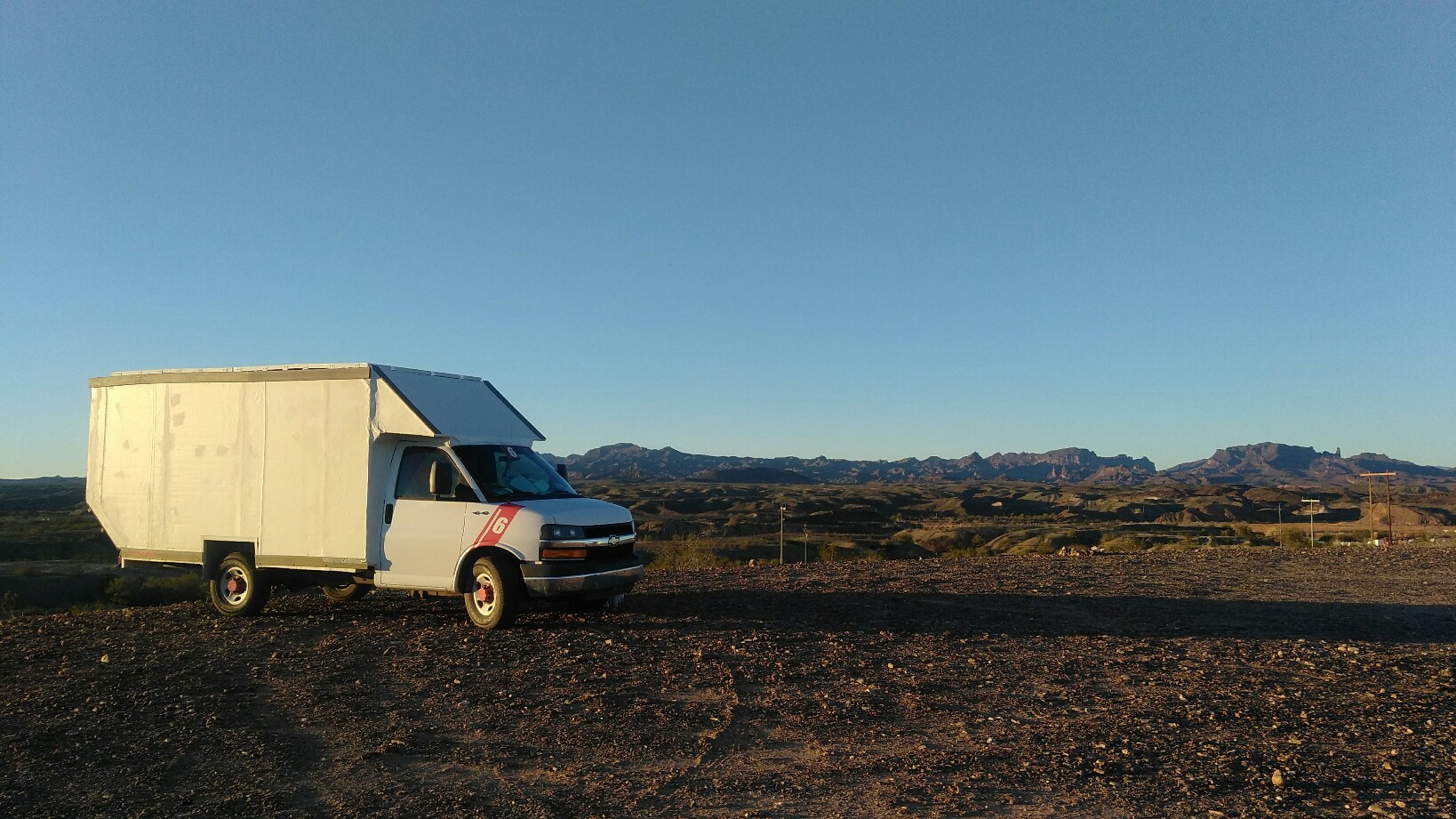

Moved van facing from E to SW to get max solar heat through windshield.
Make it so.

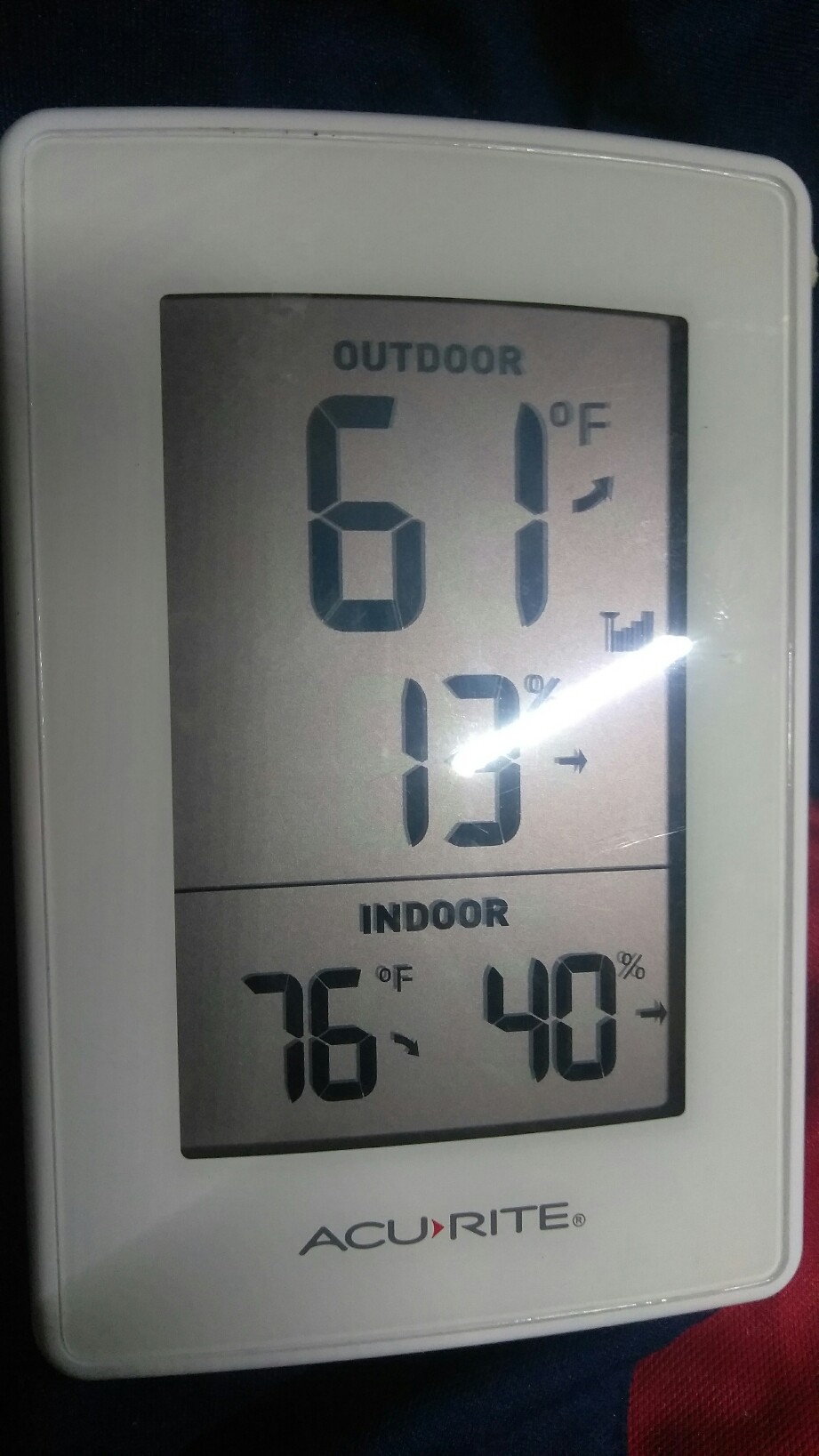

1:38pm, 59 out, 75in,

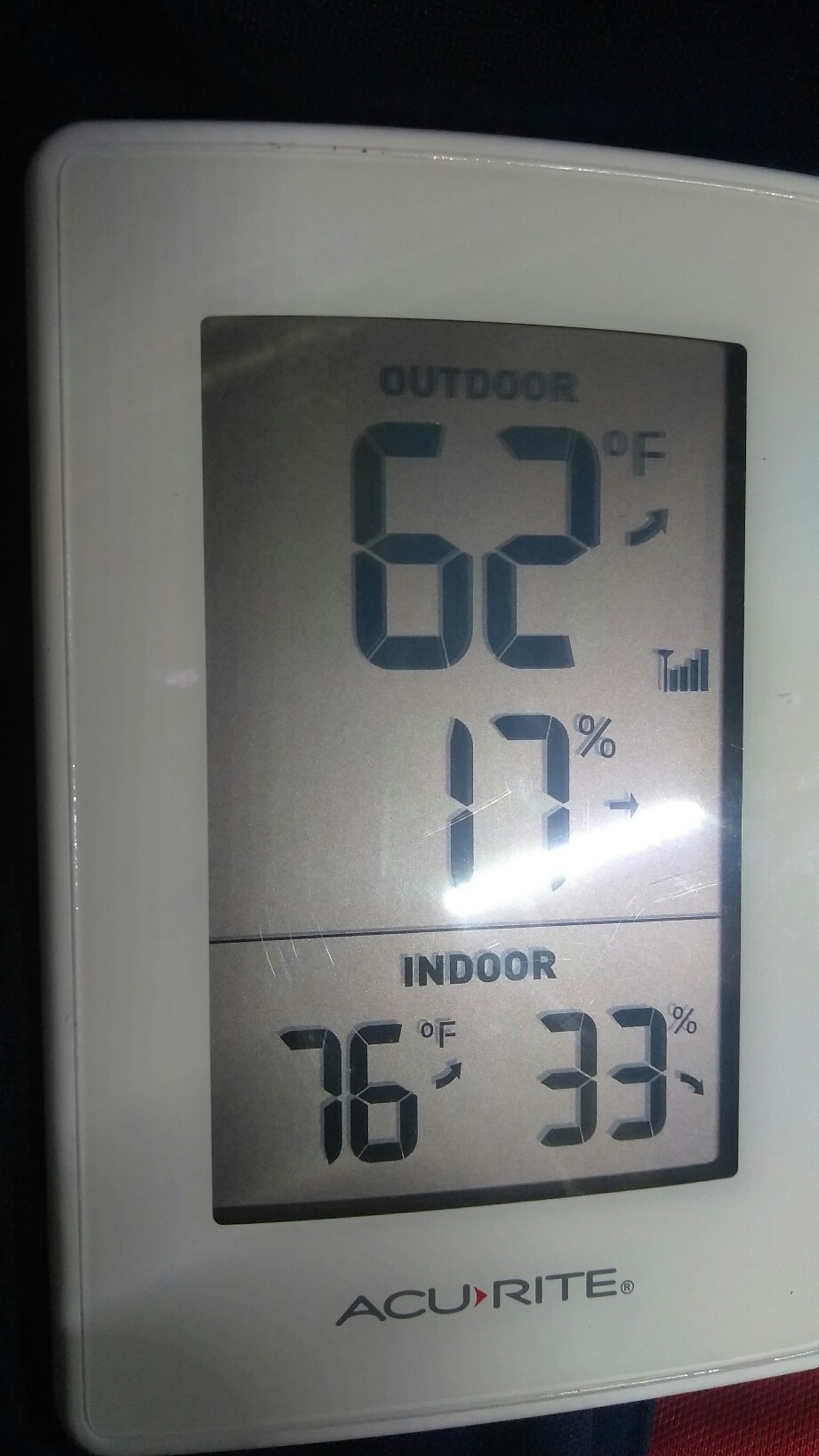

4:55pm, 62 out, 76 in

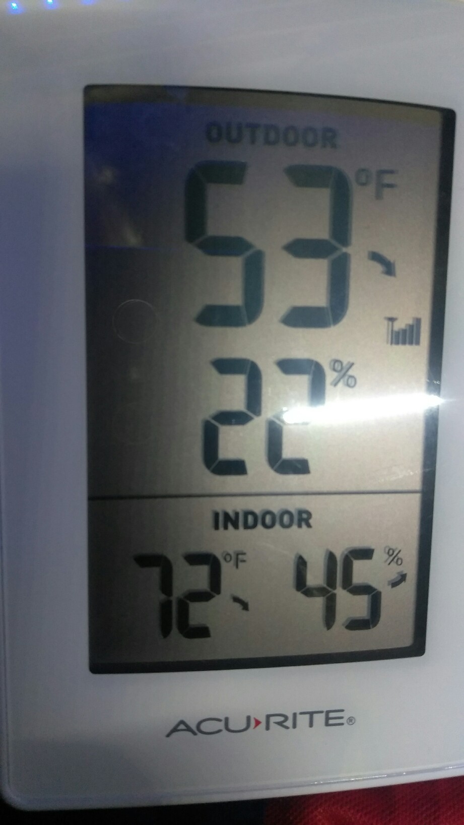

9:00pm, 53 out, 72 in.
One more reading in the morning to confirm and that will be the temperature vs insulation results for this temperature range for now. Will be interesting to see the variance in much warmer weather.

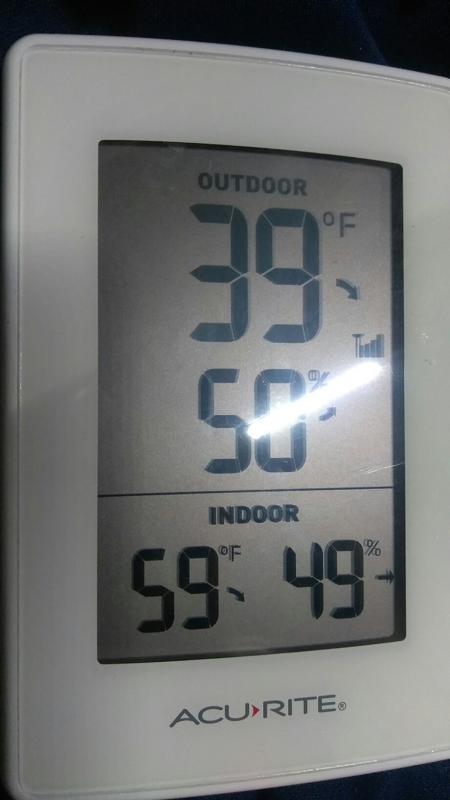

6:20 am, 39 out, 59 in, weather reported 33 outdoor at the time, interestingly enough.
My RV comparison in the class B reported 44 in his rig this morning.
So 4" of insulation retained heat from 76, down to 59 overnight, compared to a standard RV that went from 67 , down to 40.
The benefit is basically a 20 degree improvement in maintaining a more comfortable temperature, in this temperature range, when compared to a standard RV. In plain terms, this means less chillie willies and enhanced benefits comparable to Viagra. :lol:
