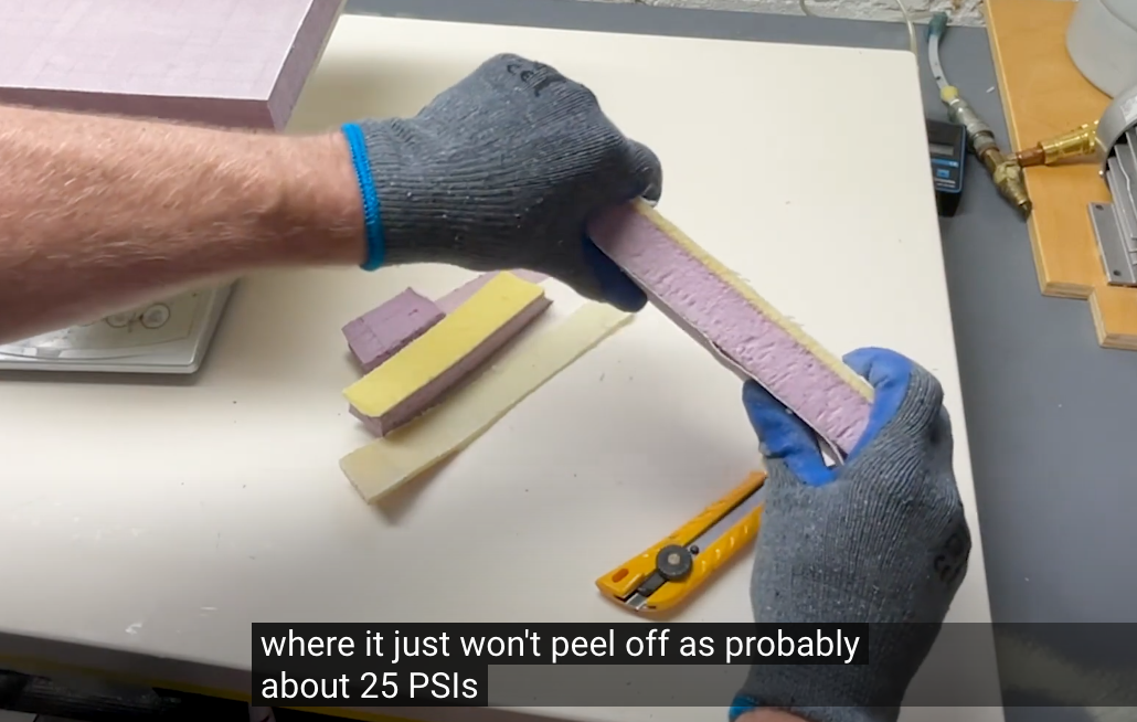

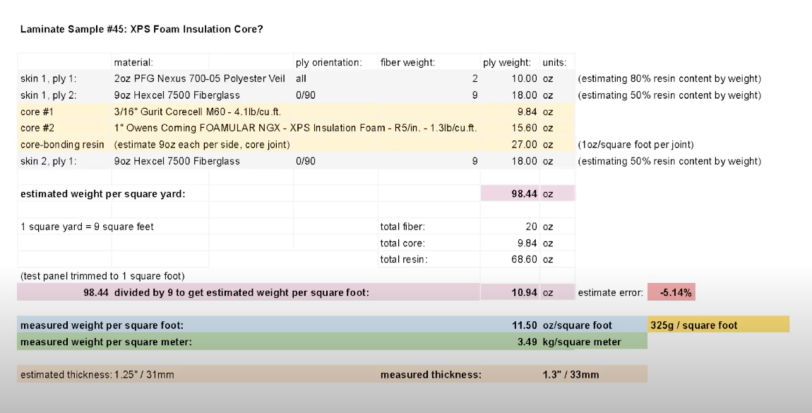

Postby fonsan » Sat Mar 04, 2023 12:32 pm
https://www.youtube.com/watch?v=z9iySKmGPeI from the excellent explore composites channel
He is using 1.5lb/cubic foot XPS which is about 20kg per m3. He does not state but looking at the poor surface adhesion he is reaching he has probably not sanded with corse 40 as recommended.

The XPS that is available to me in Europe is 50% more dense, 33kg per m3 and has 250kpa (36 psi) or 300kpa (43.5psi) compressive strength. He is also using 1" foam which limits strength of the sandwich i plan to use . Remember that doubling the core (foam) thickness will give 300%-400% increased bending resistance.
He did go the same route as I have in regards to surfacing with a 9oz roving and surface veil for smooth surface. I am going for 10.7 oz roving and 1oz veil and I plan to hand laminate not using vacuum. The price really dictates the choice of fiberglass, a 200g (7oz) woven is 200-300% more expensive per square meter compared a roving 300g (10.7oz). I paid 131€ (140$) for 150m2 (1516 square feet) for the roving and the 1oz veil is 0.5€ per m2.

Sanding will certainly help, as well there are other methods like poking small holes in the surface that the epoxy can get a grip on. In the industrial world, the facesheets are attached to the core with a layer of adhesive. Facesheets have a strong tendency to peel from foam core.
fonsan wrote:The XPS that is available to me in Europe is 50% more dense, 33kg per m3 and has 250kpa (36 psi) or 300kpa (43.5psi) compressive strength. He is also using 1" foam which limits strength of the sandwich i plan to use . Remember that doubling the core (foam) thickness will give 300%-400% increased bending resistance.
The core reacts shear -- the bending resistance is virtually unchanged. As long as the core shear allowable is not exceeded, the core will not fail irrespective of the bending. The facesheets are very much stiffer than the core. The load in the core relative to the load in the facesheets due to bending is not even used in the calculations (it's so small it's thrown away).
