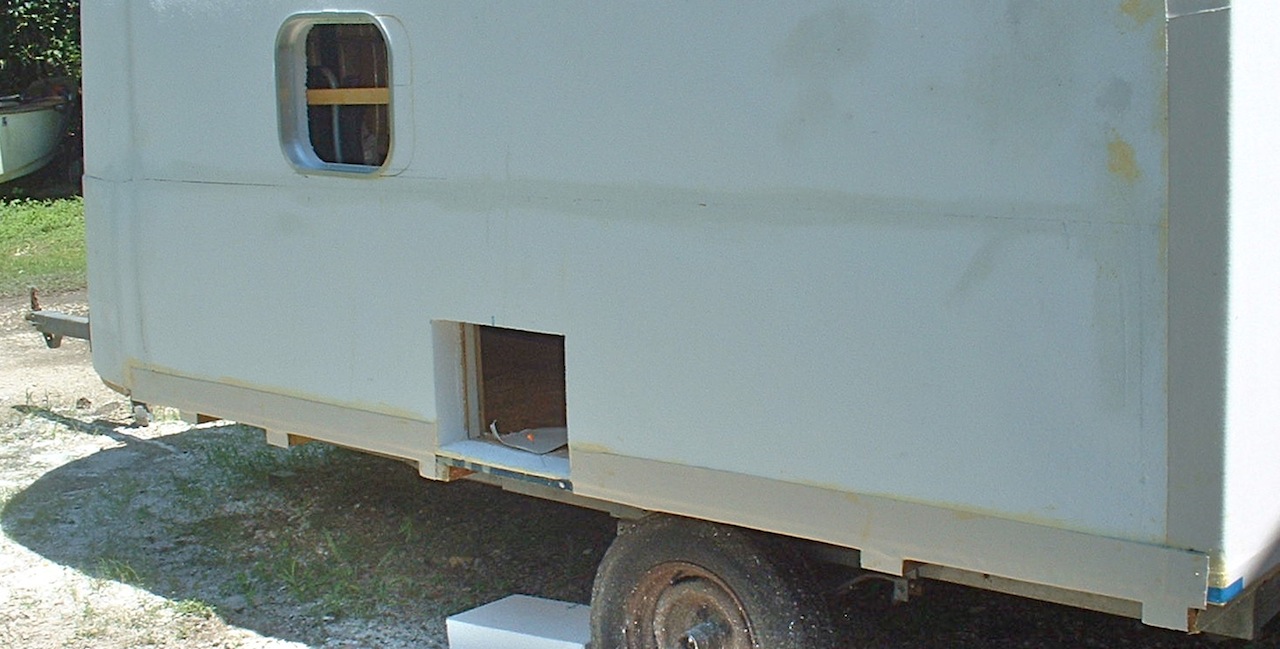

Permanent windows is OK with me ... as long as they open and close :thumbsup: 8) More permanent , the Better eh !!!
Hindsight , always 100% accurate , and always a bit too late ... :R Good thing it was Foam or it could have been real problems ... this is still laughable ... but embarrassing none the less ... :oops:

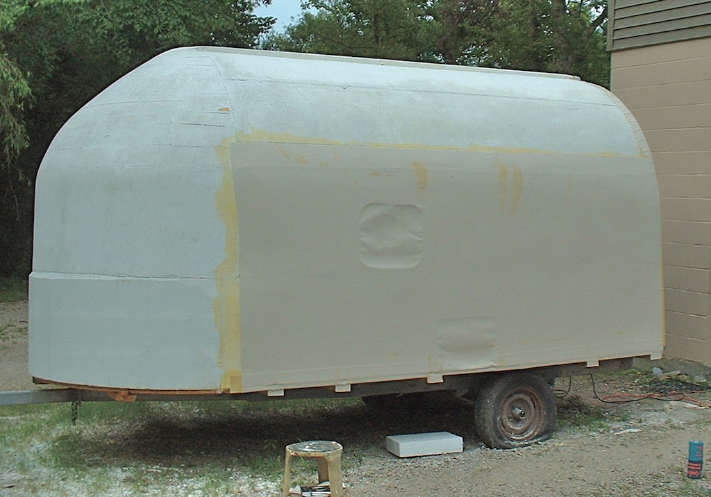

Got the reinforcing strip attached on one side ... then decided it was just too darn Hot to be working out there... And I’m not supposed to be out in the Sun anyway ( BP meds)... :frightened:
Note: I was going to cut/bevel those ends of the cross members , but decided that would be a good place to screw on a final trim strip to “finish off” the bottom ... :thinking:
Re: FoamStream...
Postby GPW » Wed Jul 10, 2013 12:02 pm
Ps. I did run a chalk line first for the reinforcing strip and one for the the 56” (actual 60” X 10.5’ ) large canvas piece that extends well up into the curve of the roof :o ... the other 4 “ will overlap the reinforcing strip under the floor ... That’s just Gotta’ be STRONG !!!
Got a cheap roller pan to use for the T2 ... will have to roll it on ... too large for brushing ... ;)

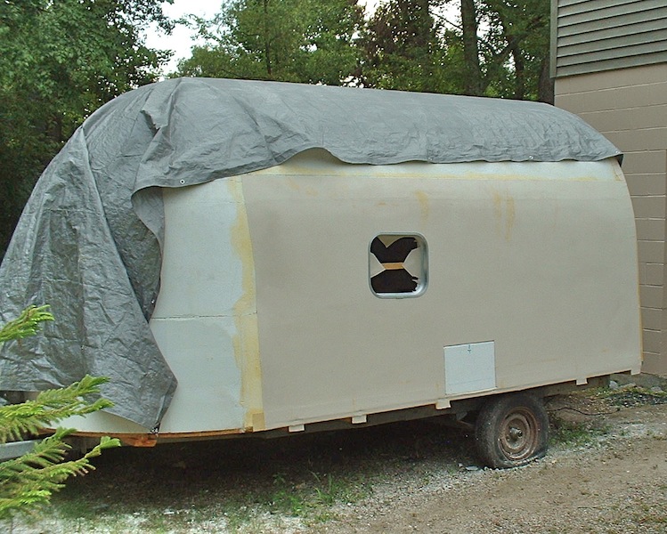

Pulled the tarp back ... the big panel survived the dampness of the night , still stuck fast , but a bit damp as yet, but then Everything’s damp here ... :roll: Surprisingly the somewhat slack window and AC cutouts were now tight as a drum ...so there was some shrinkage although not evident on any of the edges ... :thinking: Made the slices for the openings , not glued yet... so here’s how it sits now ... awaiting a bit of the drying Sun... :rainy:
Errrrr, anybody notice that I got the window opening a bit crooked (although I measured twice , obviously wrong ) ... :shock: Have to “work” on that ... :oops:
