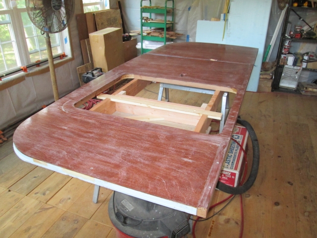

Anyway, here are the pics from Sunday.
Scuffing down.

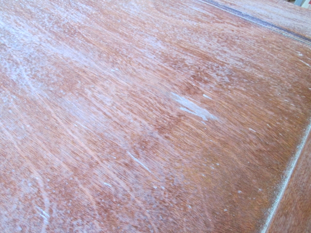

Close up of gummy area.

WW, the finish schedule so far has been RO sanding with 180, 220 and 320 grits (except the front of the bulkhead which only got 180 hand sanding, IIRC, maybe 220 grit on hand block); wiping with a dry Scott Shop Rag paper towel (I also experimented with using compressed air to blow the sawdust out of the grain, but this seemed to open up more pores); Minwax Red Chestnut stain (basically the time that it took to rub on, rub to equalize, wait a few minutes, and rub back off); Minwax High Build clear gloss oil based polyurethane applied with a synthetic bristle brush (intended for poly… maybe 2-1/4 or 2-1/2 inch…can’t remember… big box store, not the cheapest, not the most expensive); wait 24 to 72 hrs.; hand sand with the grain using 1x2 oak block wrapped in 1/4 sheet 220 grit; hand scuff with 1/4 sheet 3M greenie pad; wipe with paper towel; wipe with mineral spirit damped paper towel; apply a wet even coat of poly trying to hold a wet edge; tip off with long overlapping even strokes before tacky; and wait again.
I thought 3 coats were going to do it (like on the floor and doors), but tonight when I went out I had a few things I didn’t like. The areas that broke through into gum didn’t fill level, and I have a new issue. There were some areas that looked at first like fingerprints… small ridges. On closer inspection they look like little patch work quilt groupings of wrinkles, each group at random angles to the adjacent groups. Mind you that the overall impression is still pretty good, but when you start looking closer you notice these things.
So I busted out the 220 grit and greenie and scuffed it down again. About half way thru the galley section I realized that that panel was pretty good and I could have just left that area alone, doh.

Although the paper clogs something fierce when this happens, there is gummy stuff “in the hole” that rolls up into a tiny worms when rubbed with the finger, so I think it is more of an issue of relatively heavily coated areas and lack of cure, rather than heat. The paper does clog something fierce when I hit these spots, but I think that is the wet coming first rather than heat. Not absolutely sure, though, so I will pay more attention to that; using just the greenie as a test is a great idea. I will try that!

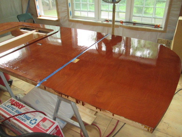

Out to Mecca, rubbed down the panels with mineral spirits and laid on another coat of poly. The 4th coat.
Did things a little different. Added maybe 1/4 to 1/2 cup of mineral spirits to about 2 - 3 cups of the high build poly. Probably not enough to make much of a difference. The only thing I noticed was that there seemed to be a foamy raft of bubbles floating on the surface of the pot the whole time.
I took extra care to keep a dry brush around the door flanges and toe kicks, and tried to keep a drier brush in general (since the surface is fairly sealed and smooth now, that is easier now). Took extra care to sight askance with the light more frequently (rather than waiting until the end) so that I could remedy dry areas sooner while still relatively fluid/less tacky.
The wet coat looked decent, and if all goes well drying I'm going to call these two surfaces done and move on. At some point after time has passed I might sand with 320 or finer, buff and wax, but that will probably be after final assembly. I'm too mired down in details and the big picture is looking good, so I'm moving on.
I did take a couple more pics, but they don't show the trouble spots too well, and are just more shiny wet surfaces, so I will tack them on with the next photo dump, or not. Pics are all starting to look the same, so I guess that is a good thing. :wine:
