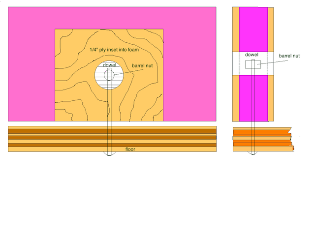

How about something like this , where plywood plates are recessed into the foam to spread the stress out over the surfaces... you get the basic idea ... Image
Although the cloth and glue works Fine for floor to wall attachment (worked for Eagle ) This may be OK for attaching things TO the walls , like a shelf or something that would support a little weight ...
So how do you cut that recess in the foam?

A router and a template make quick work of cutting the recess ... Just foam , but a little messy , as with any router job ... In a pinch you can just cut around the outline and dig out the inside to 1/4" deep with a knife ... not entirely accurate but the gorilla glue fills in any gaps ...

I see now you used the dowel AS the barrel nut ... :thumbsup: 8)

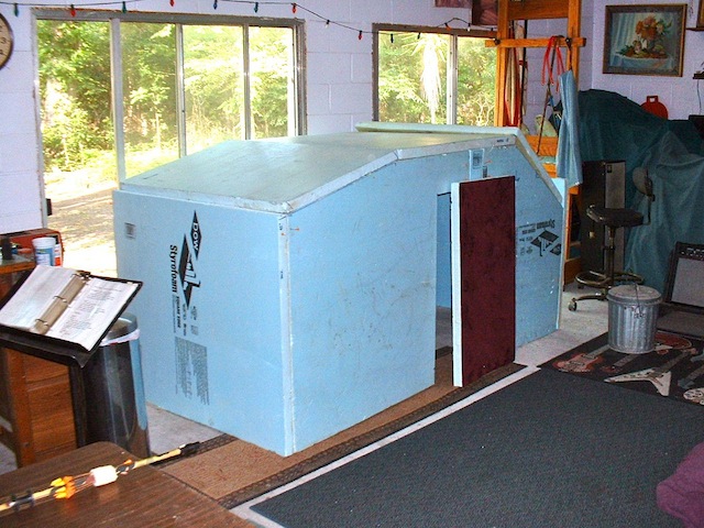

Here's my second mock up .... just checking fits ... held together with darts from my blow gun ... works !!! Inside's pretty much done except for the inner reinforcing strips and paint , all done after assembly ... ready to stick it to a ply floor now ... Image
