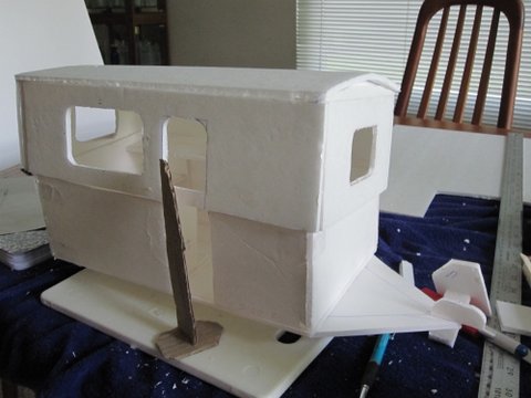

After preshrinking my 12' x 9'- 10oz drop canvas from Harbor Freight and put in the sun to dry, there were many wrinkles in the canvas.
My question is before I glue the canvas to the top and sides , should I iron the canvas to take out the wrinkles or will it not make any difference?

TS, Iron it if you want , or just dampen it slightly before applying .. If it’s real thick , then ironing may help ... :thinking:
