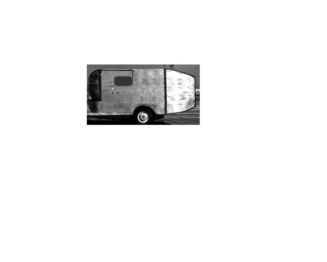

Here's a question. How much depth is needed to make the air flow around a front and at the moment flat surface? Is the purpose to disrupt the airflow or to channel it along flat sides. With foam we have a lot of options for shapes and designs. I don't have much tongue length to lose. While I may eventually put a simple A frame under the BUB, right how I'm just working out the top design. The tilt of the from should be enough to blend into the airstream on the car, I'm just wanting to maximize the air flow I guess. I'm not looking at adding any volume to the trailer's usable space, nor was I looking for an integrated tongue storage box, though I am open to ideas.

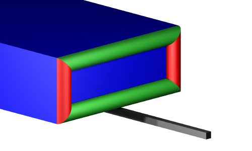

bonnie wrote:How much depth is needed to make the air flow around a front and at the moment flat surface?
Very little. What you have to understand is that it is the detail shape at the edges that really matter and not the overall shape or styling. All those slope nose or needle nose designs are just styling and are not needed for aerodynamics - at least not a road vehicle speeds. This NASA test truck body has a lower coefficient of drag than any production automobile, except for the GM EV1:
Those clear bits at the front are windows not openings.
So you need to go for the same priorities of well-rounded front edges, perfectly aligned with the sides, anywhere where the trailer may stick out as far as or beyond the tow vehicle - so there is no point getting all clever with the front-top edge of a trailer that is only half as high as the tow vehicle.
In between the rounded edges, the shape doesn't matter much, so a flat panel is fine. For that matter you can just add the rounding in front of the front panel - here is a graphic I did a while ago showing a box trailer with half-pipe added to the front edges. Something like 8"-12" plastic pipe cut in half lengthways and stuck on with mitred corners would do fine. This is as long as the outside edge of the half-pipe is perfectly flush (like within 1/8") with the sides - get it more than two inches away from the edge and it isn't worth bothering to do.

Postby angib » Mon Dec 17, 2012 8:59 am
It might be worth giving the drag coefficients that NASA measured for that test truck as it may show some effects that folk don't expect:
1) All edges square, front and rear - 0.89
2) Horizontal edges rounded/vertical edges square, front and rear - 0.54
3) All edges rounded, front and rear - 0.41
4) All front edges rounded, all rear edges square - 0.365
5) Rounded front, partial boat-tail rear (as my photo above) - 0.242
6) Rounded front, full boat-tail rear to point (as GPW's photo above) - 0.238
Remember these are data for an independent vehicle, not a trailer, so don't read too much into them. But one thing to look at is the comparison between 3) and 4) - the one with the square back end has less drag than the rounded back end.
