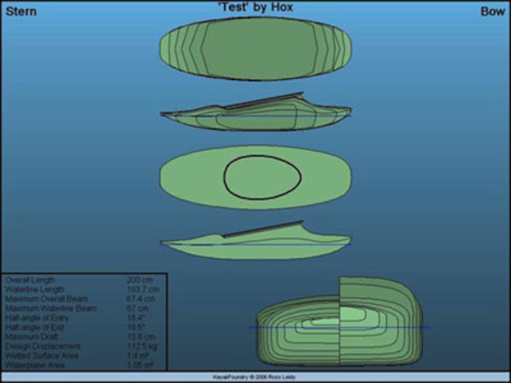

Postby GPW » Mon May 26, 2014 9:51 am
Lately we’ve been thinking something like this , just bigger ... :R

GPW- I'll leave carving foam blocks up to you artist types, I was the kid that couldn't color inside the lines and it still shows when I try to lay a tape line to make a stripe on an air plane... I would end up with a pile of foam shavings because I kept making one side lopsided, until I had nothing left....
