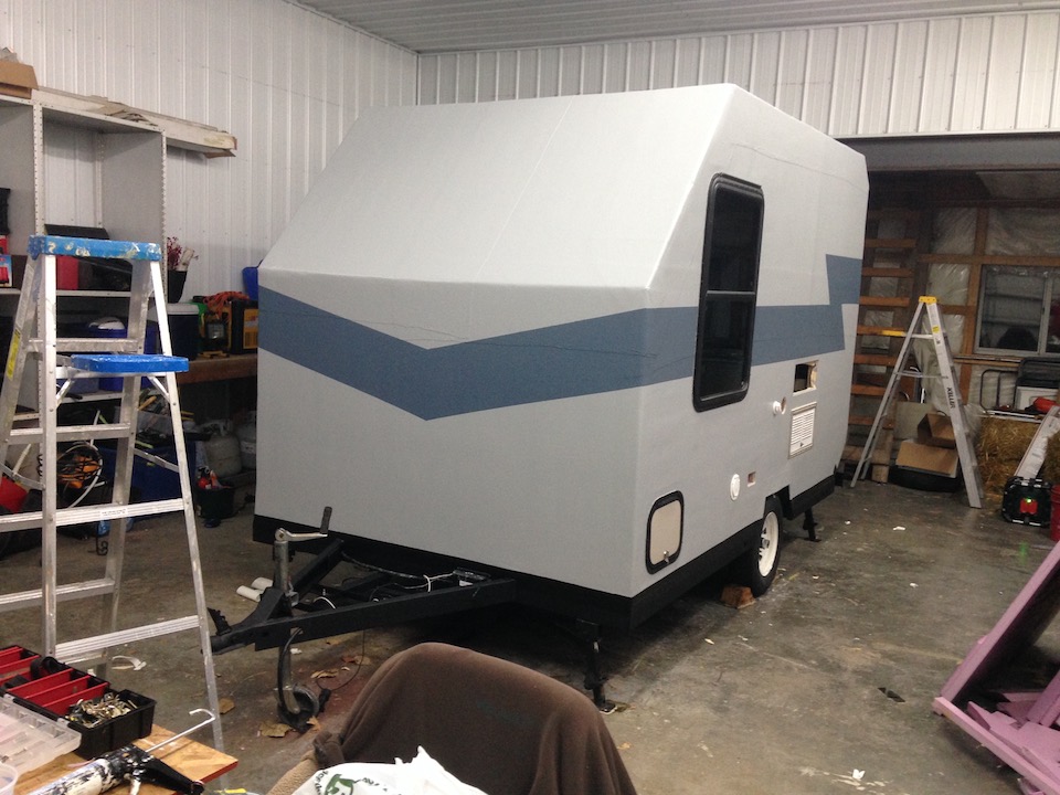

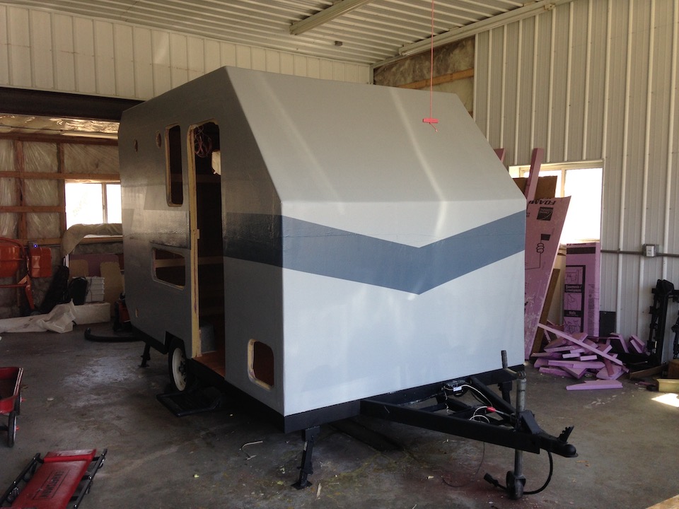

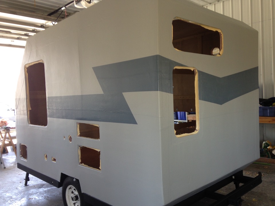

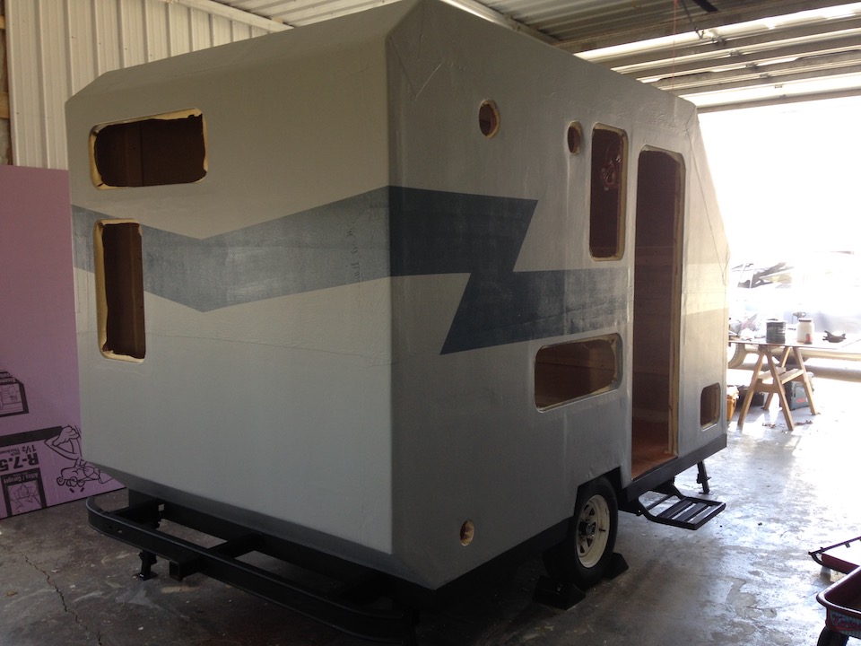

This camper got its stripe! The base paint is satin and the stripe is semi gloss. The sun was out today. Made the lighting a little weird in the barn. The three pictures below combined give a good all around view of what it looks like. The paint is a good exterior paint with an extra UV protection additive in as well. The painting is pretty much done. I'm going to paint the family brand on each side and the camper's name once we have one. I ran Blue Lightning past my wife. She wasn't all that impressed. We liked Lightning Sprite but are afraid we'll end up struck by lightning if we go with that.
Spent a lot of time yesterday and today cleaning and organizing the shed. Shrinking the mess so I have room to get going on the next step. On Tuesday I'll get going on the next phase. Finishing Phase.

It is fun to be at this stage. I even allowed myself a few beers Sat night. I think the hangover helped me take my time with the stripe on Sunday, prevented me from getting to ambitious with the paint scheme and had an overall positive effect on the camper.
We're pretty pleased over all. The side wall panels run vertically. At the same spot each side you can see the butt joint between two panels running from top to bottom, I'm surprised at how apparent it is. Still I knew it would be there. I rushed past fairing out the body, I can live with it now. If I had shaved some of the proud foam off and then smoothed them all out with lightweight spackle they would not be there. This camper with paint is super solid. I have never seen, in person, another camper this strong. When you palm slap the side the whole thing plays like a drum. Its really cool.

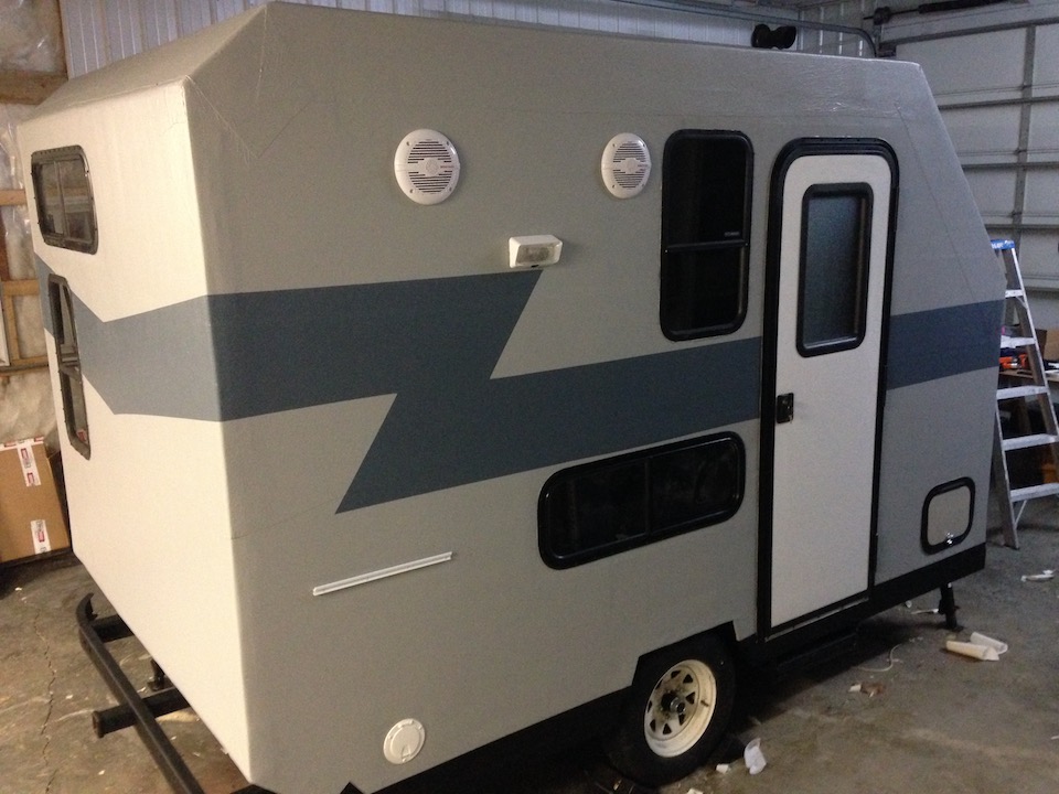

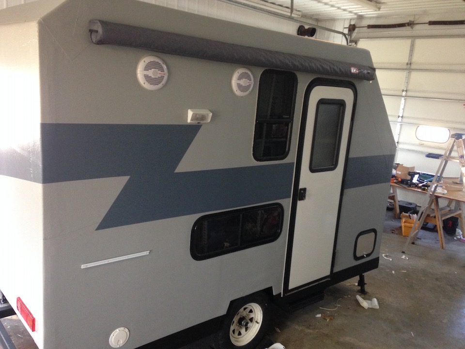

Windows and doors installed today. All that is left are the brake lights and the awning, both of which will go on tomorrow morning. I still have an open hole for the fridge, the water fill dish and the heater vent. I am going to do these as I install the kitchen.
I used butyl tape behind the flanges. Found 150' for $30 on amazon, came in 5 30' rolls. They called it putty tape and also butyl tape in the ad. I took a chance after reading reviews. It was butyl tape not plumbers putty. I drilled holes through the flanges and used these 1" square drive, black head, zinc plated RV screws to install everything. I used some salvaged white screws from the old pop up camper for the white things. Everything worked as planned.
I have some grey caulking but it is noticeably lighter than the paint. I might have to return it for clear. I am thinking maybe I will not caulk at all. I only did a little bit before I decided to stop and think on it. I feel good about the butyl tape and I don't necessarily want a bunch of caulking ringing all my doors and windows as it will eventually get dingy, especially if its already not the exact same color. What do you think? Caulking or just call it good with the tape?
So tomorrow is going to be brake lights, awning, then on to the interior. Thinking I will do the bunks first followed by the kitchenette which will lead to the dinette bench.
Below are some pictures of what I installed today. It looks like camper now.

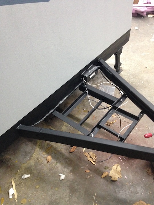

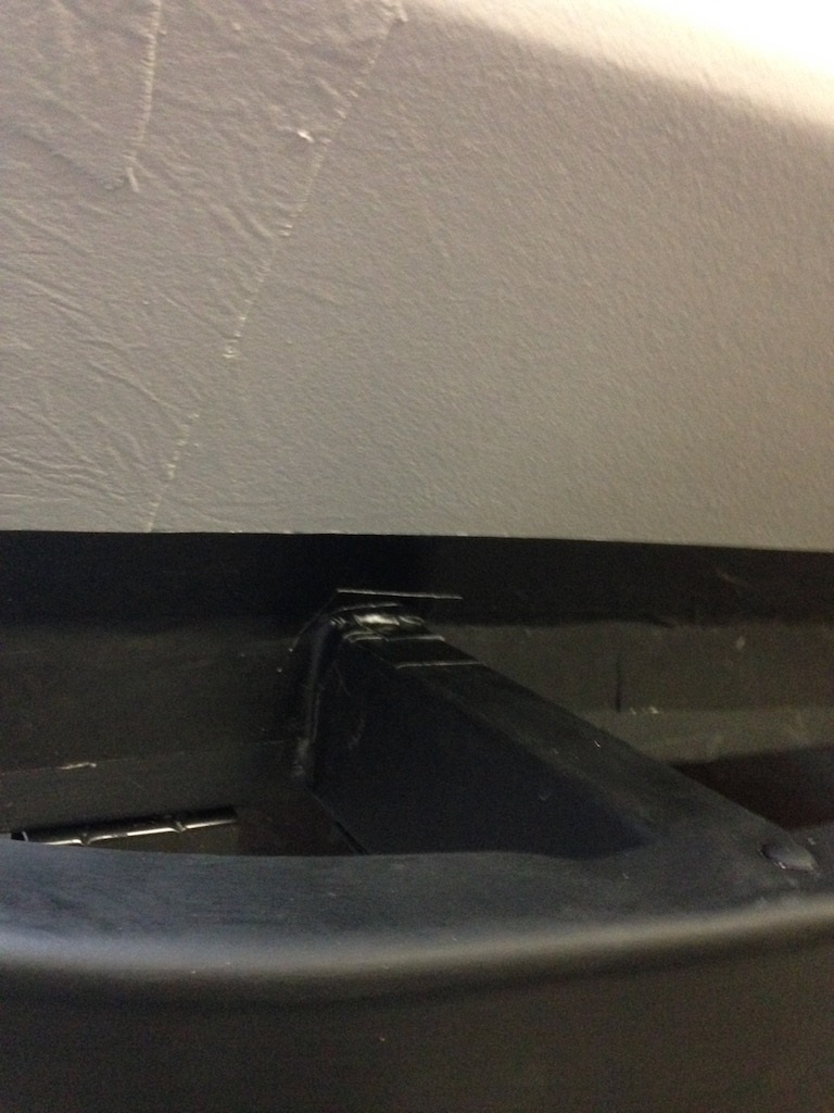

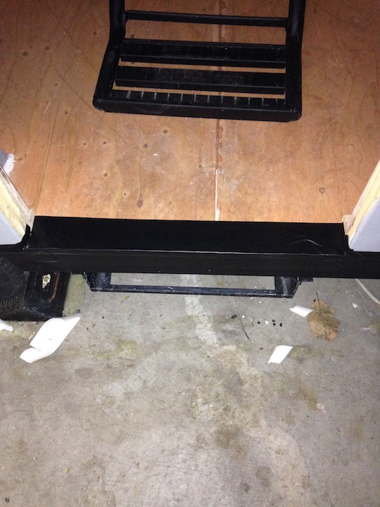

I installed my camper box to frame drip flashing today too. I made sure it runs under the door as well. I used a butyl tape for this flashing:
ProTape (brand) flex and patch butyl tape. It is sealing tape. The tape is only sticky on one side and comes in different widths and in white or black. I guess it is often used to repair pool liners and people get a season or two out of it. White ones are available in all widths. They must be having production issues with the black stuff because I could not find anything available narrower than 6 inches. I found ads for 2" think but they stated the product was currently out of stock. Everywhere I looked this was the story. So I grabbed 6" by 50', which ended up working out really well. I thought the stuff was very easy to work with once I got used to it. I put a 6 inch piece in back under the boat tail. I cut a bunch of lengths in half and put 3" wide pieces around the camper box sealing it to the frame. I like the tape. I cannot speak to longevity right now but at this moment I would definitely do it exactly the same way again. It seems really neat.
I have pictures of the tape installed below so you can see what it looked like stuck on the camper.

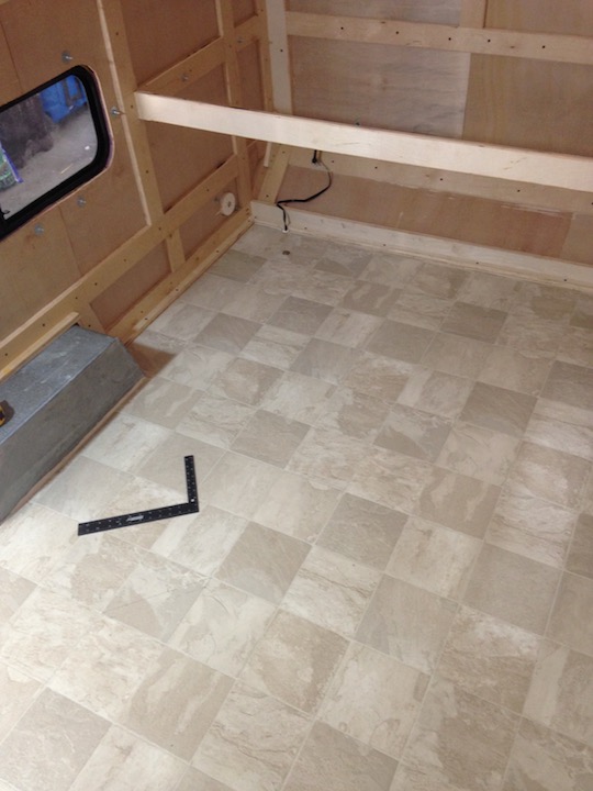

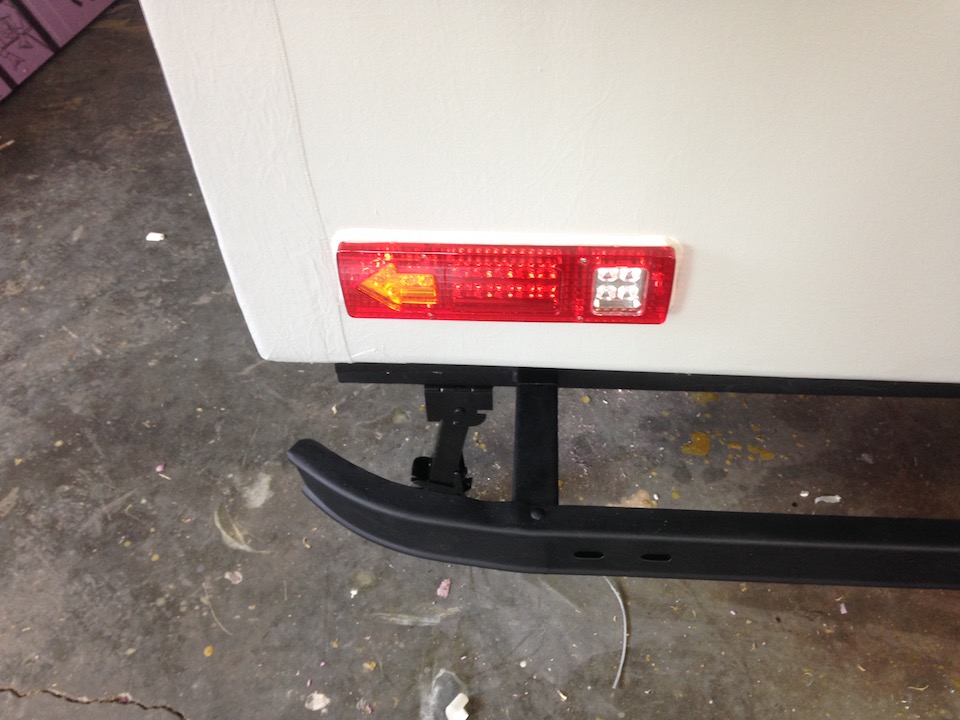

Got the tail lights and the awning on this morning. Got the tail lights, exterior speakers and porch light wired and put the floor down. The tail light wiring slowed me down some but I got it figured out. The wire colors were all wrong.
I also figured out that my brake controller is sending power to the brakes when I press the brake pedal, which is great. It also sends power to the brakes intermittently when the right blinker is on. Like in time with the flashing light. At first I thought there was a short somewhere in my trailer wiring I eventually ruled this out by completely disconnecting the right turn signal wire from the trailer, my brake controller was still showing the flash with the blinker. Now I remember thinking I was having this problem last year with that heavy hybrid. It didn't bug me too much but you can feel it a little bit with the blinker on at slow speeds. I generally keep my trailer brakes applying lighter than average pressure os intermittent flashing power to them isn't huge on the freeway when changing lanes.
Still, what did I do? Did I tap into my right blinker wire instead of the brake wire under my dash? If so why was it hot when I hit the brakes? Why does it activate the brakes now when I depress the brake pedal? Is there a short somewhere else in my Highlander?
I don't have time to figure this out. I'm not doing the west coast trip as is or running a four flat with no brakes unless there is no other option. I am going to bring it to a trailer and hitch shop and let them get it wired right. Errgggh!
:x Oh well. At least it will be right, which apparently will be better than I was able to do. I hope its not a mystery short somewhere in a wiring harness... Then I'll really be kicking myself.
:) LOL

Below are some photo tags of my interior. The two rear corners. Together they show the four bunks with the feet overlapping. On the one bunk you can see the first side of the kitchenette cabinetry up. In the other photo you can see how we angled the upright support to give a few more inches of flow around the corner. The bunks are 30 inches wide. The two on curbside are 75-76 inches long. The two on the back side are 77 inches long. Our foam matts are 76 inches long and 30 inches wide. One bunk for each of us. Every bunk has a window. The head of every bunk opens into the middle space of the camper. These bunks have better than average head room. My wife will even be able to sit up fully on her bunk with a few inches to spare. Mine is a little short for that but not by much. The uppermost one is shortest but my son doesn't care, he's just happy to have the "top bunk".
